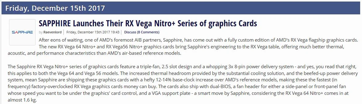

https://www.techpowerup.com/239730/sapphire-launches-their-rx-vega-nitro-series-of-graphics-cards
