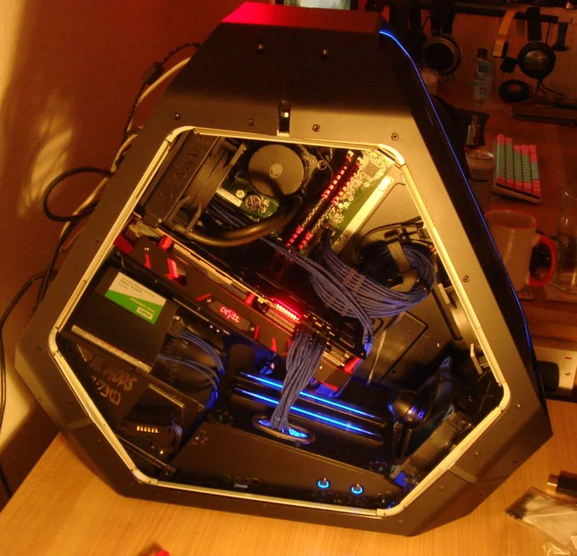

Awful pic alert (I had a lamp shining on it)
I cobbled the rig together so I have a spare rig for my mother's house. Works nice, very quiet too. I just left Valley running for an hour and it topped out at 64c. I didn't hear the fans spin up once (they won't until it hits 70)
So yeah, very happy indeed :)
Living upto your name anyway :p, case looks decent with those generic sleeveless psu's taken out. The amount of money those things cost you would think they would go with decent psu cables, even though its not a windowed case.

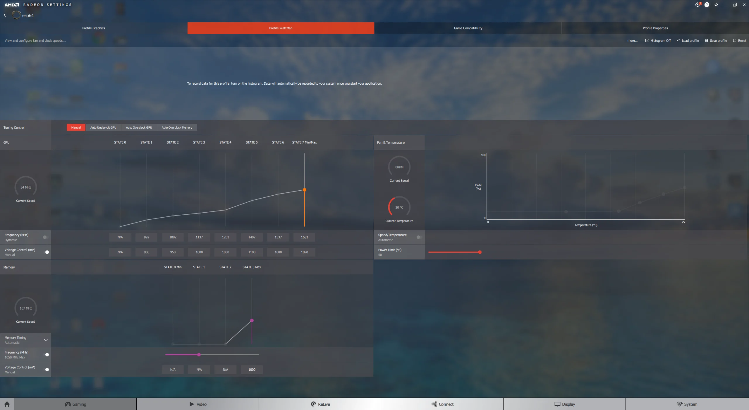

Look, you can use Wattman with the latest drivers, undervolt as normal and the cards work fine. The settings I have posted a dozen times the last few weeks, work perfectly.

Yes are posted on this thread, and here how they look with the 18.12.2 layout :)
If you want to cut more power reduce the Power Limit to 30%
