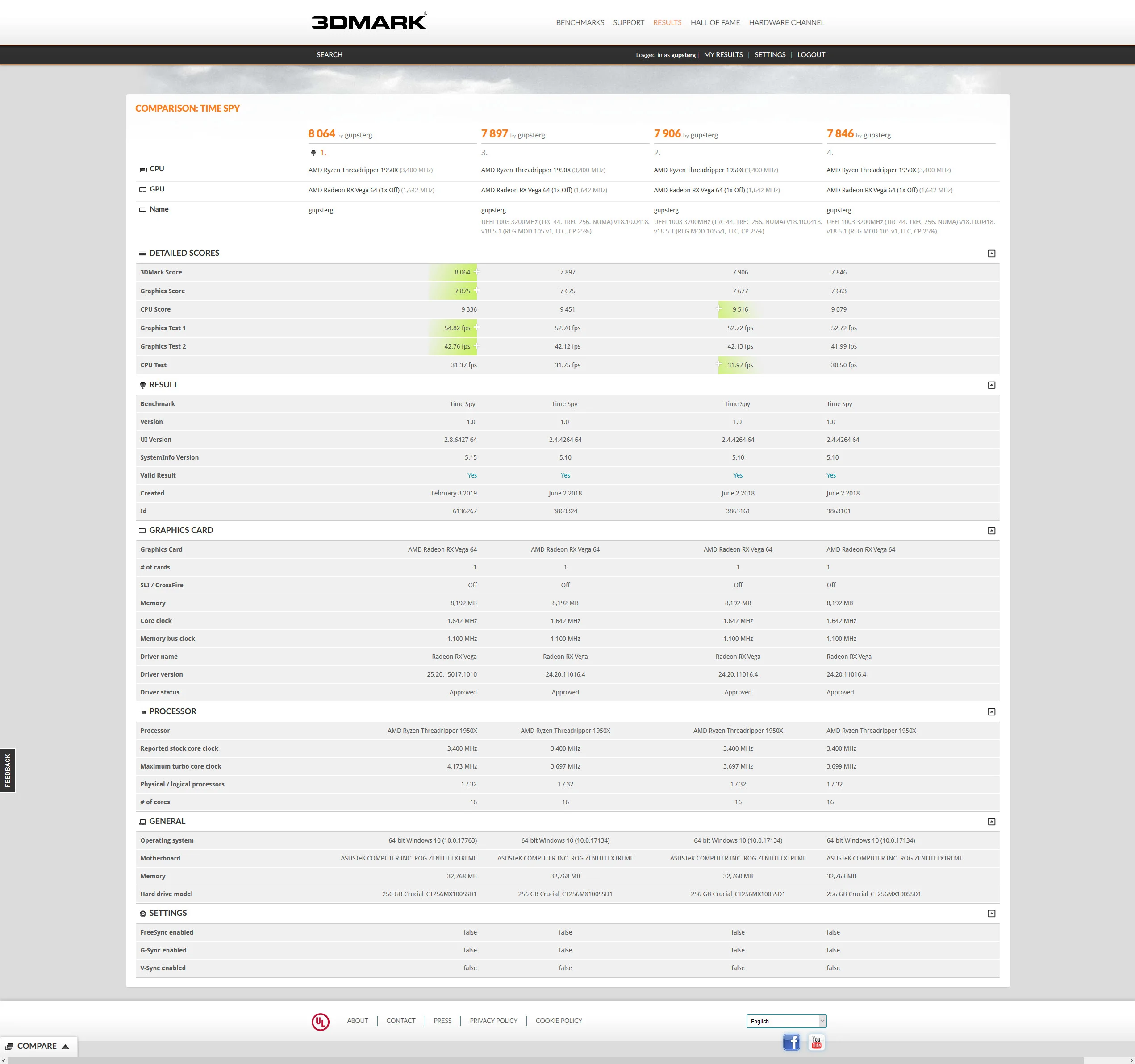

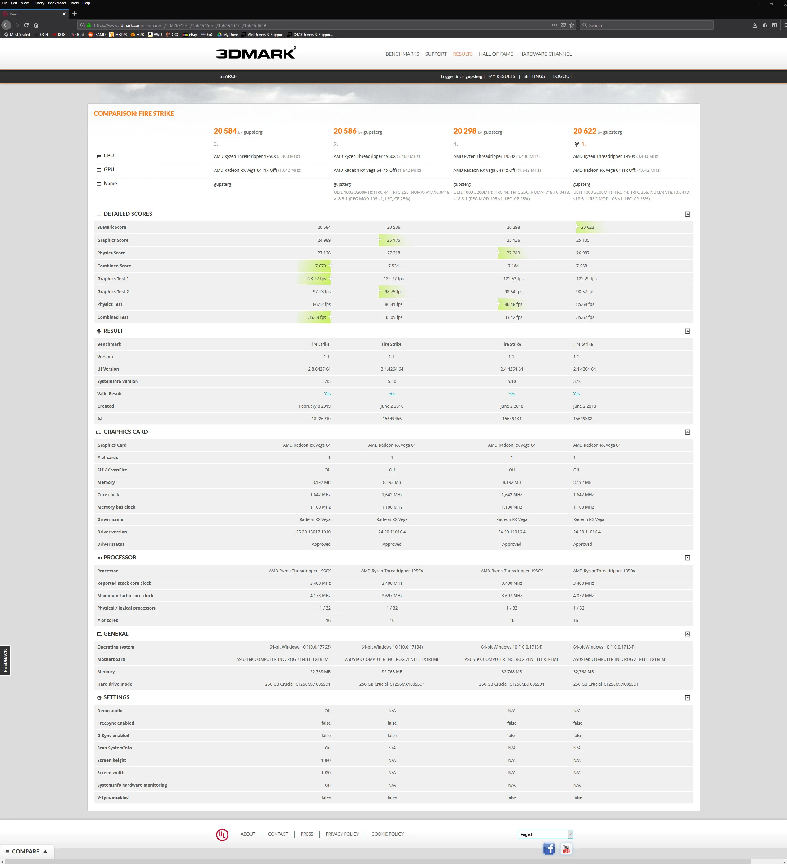

For me latest drivers are going well.
Since launch drivers it's been "hit'n'miss" appearance of VRM temps in SW monitoring. So glad it's always there now, gives me more complete data for runs of tests. So far in benches is the same or ever so slightly better performance than past drivers.
4 way compare 3DM FS
4 way compare 3DM TS

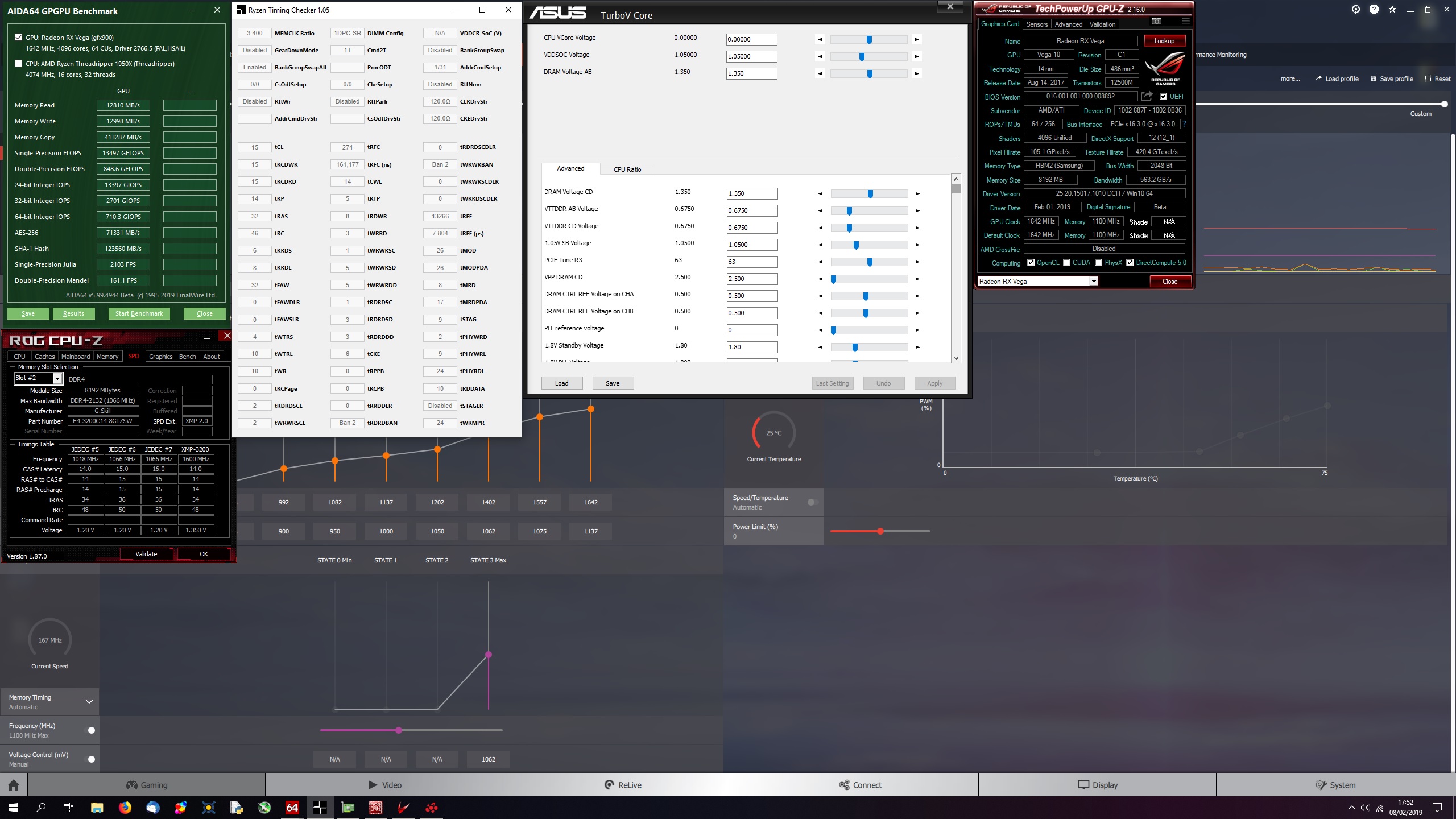

The OC I set ~1yr 4mths ago is still holding up in games, f@h, bionic, etc. Only thing that has happened is few months back instead of 1125mV for P7 I use 1137V, card was WC'd 2nd day after purchase.
Nice also to finally see in Radeon VII launch reviews clarification on "hotspot" for GPU. At present see no need to jump from V64, just resisting the temptation to get a V56 Pulse to WC and use on another rig...

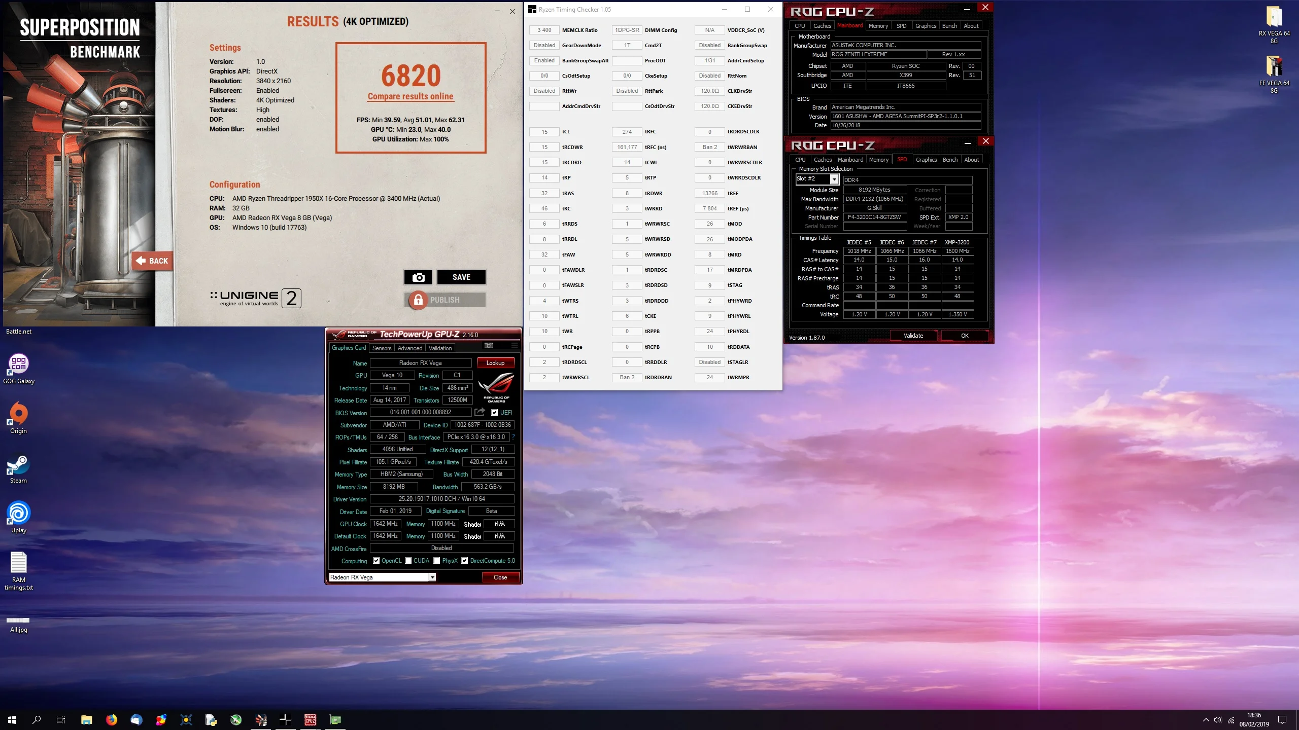

I got 6741 in 4k optimised for my quiet, low power setting, 6976 for my 1702/1150mv P7 faster setting.
Mid setting, around 6871 - all 4k optimised.
Best I can get so far is 6707. Thats with P6 1680/1065mv and P7 1712@ 1085. Memory is P3 950Mhz/1025mV
During the Superposition benchmark my clocks tend to level out at the 1640's. How do I fix that?
