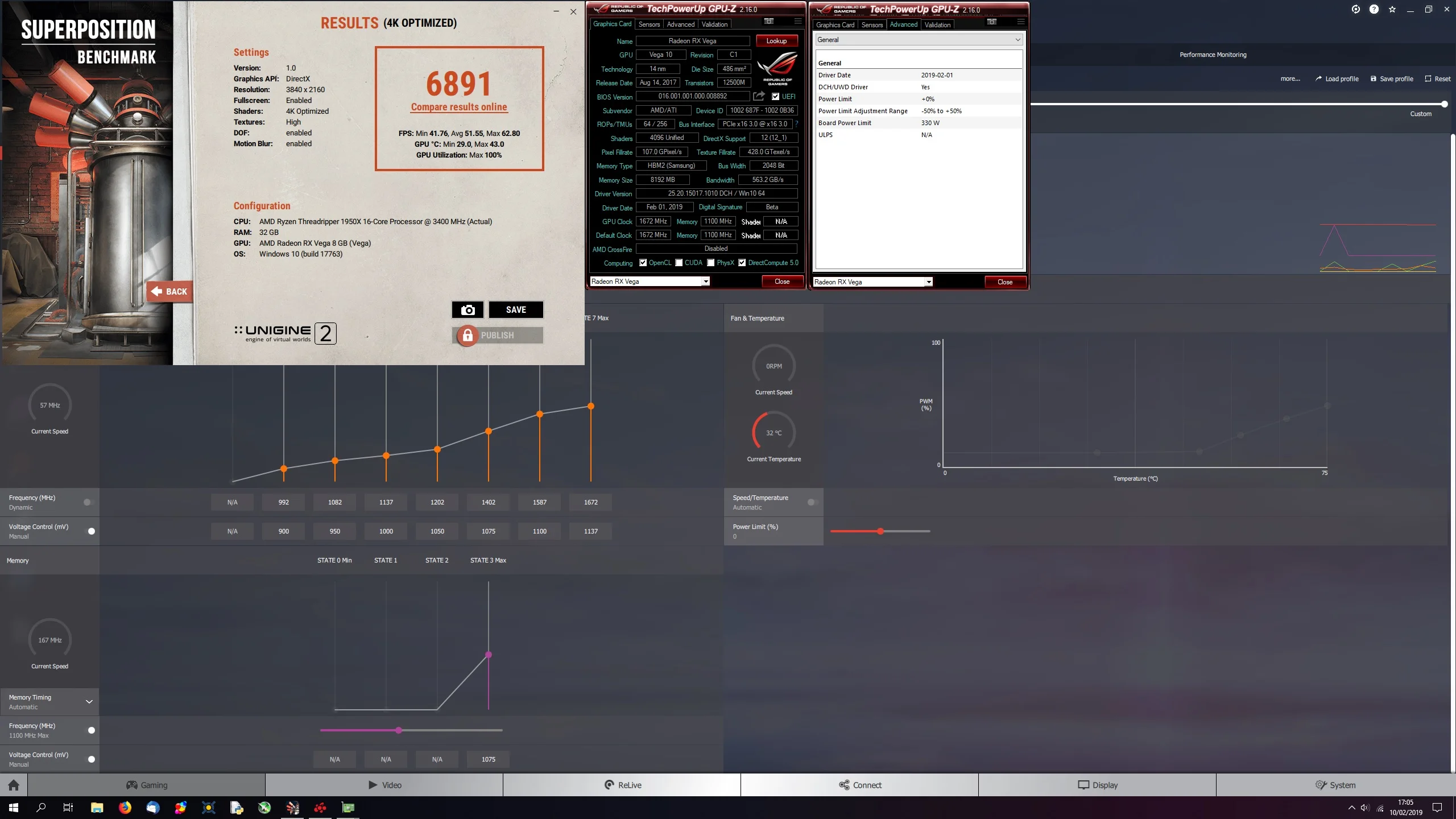

Best I can get so far is 6707. Thats with P6 1680/1065mv and P7 1712@ 1085. Memory is P3 950Mhz/1025mV
During the Superposition benchmark my clocks tend to level out at the 1640's. How do I fix that?
You don't - that's a good clock speed :)
I'd be happy with that.
Mine was sitting around 1615mhz gaming.
TBH, there wasn't a noticeable difference in FPS at 4k between that and running around 1550mhz, but a lot less power used.
Have you tried your memory at 1100mhz/1000mv?

Increasing mem to 1100mhz/1000mv helped me break the 7000 mark.
Got some artifacting in ROTTR benchmark so scaled it back. Seems to be stable at P6 1695@1065mv P7 1730@1085mv. Gives me a score of 6974 in 4k superposition.
I'm happy with that.

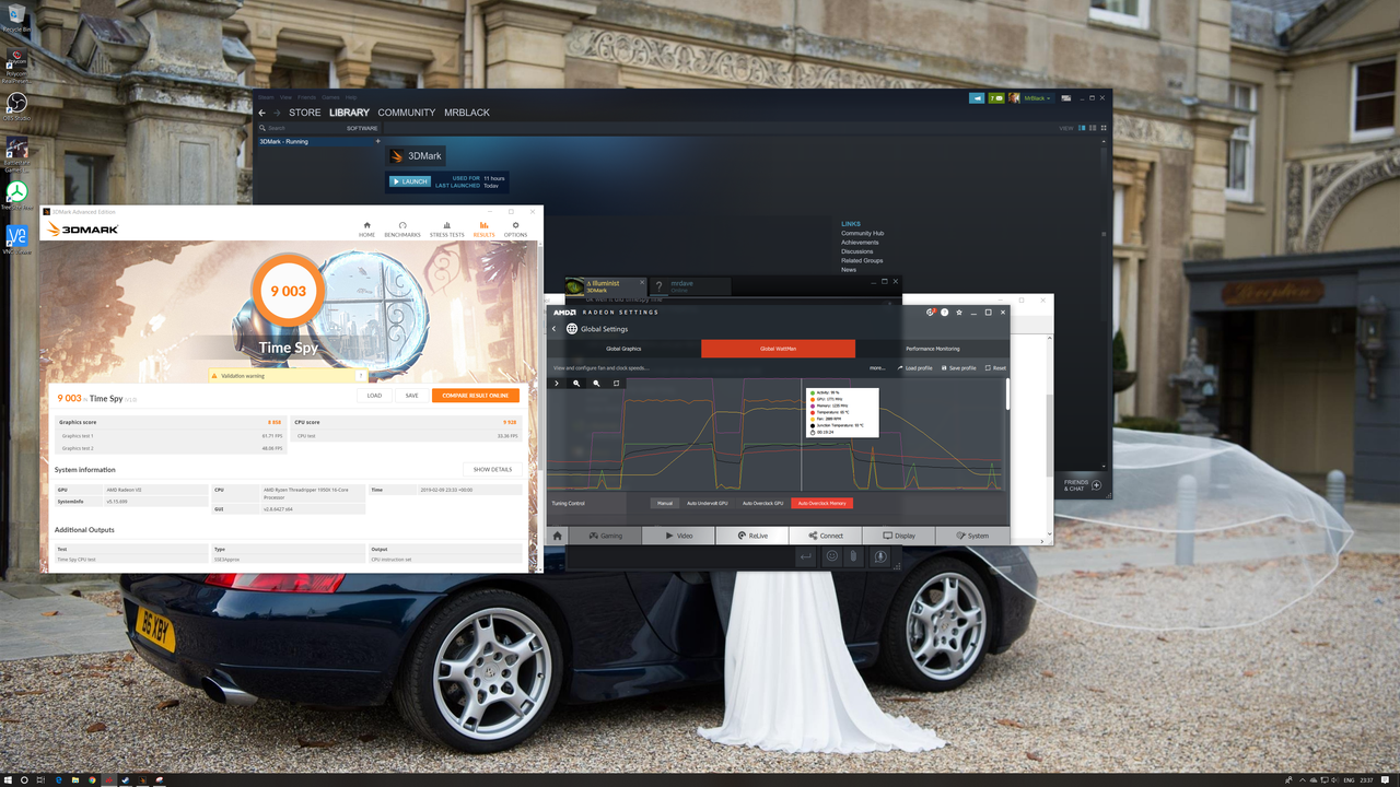

Coaxed a bit more from the V64.
Passed 3DM stress tests of FS/FSE/FSU/TS/TSE and does well in f@h.
As far as I'm concerned the gain is on stock effective GPU voltage. Below is f@h fully stock vs current setup.
