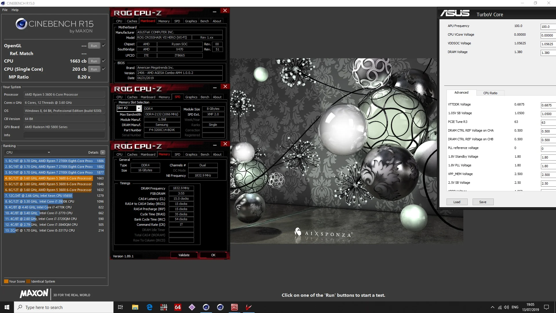

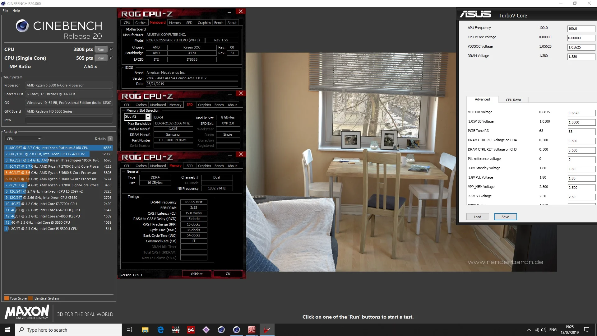

~4.35GHz, can be ACB depending on load, have also been to PBO+200MHz, but frequency bounce down can be bigger, so as current settings favour PBO+150MHz and gain more sustained all cores frequency of 4.35GHz in most loads I reckon that's sweet spot for my setup.
Usually averages ~50C max ~60C in Kahru RAM Test, averages ~67C max ~71C in RealBench, average/max ~74C P95 v29.8b3 with AVX/AVX2/FMA3/FMA4 disabled using 160K in place FFT.
The runs of CB R15/R20 has my own 2700X with PE: Default and PBO: Enabled vs R5 3600 stock, PBO+75MHz, PBO+150MHz.

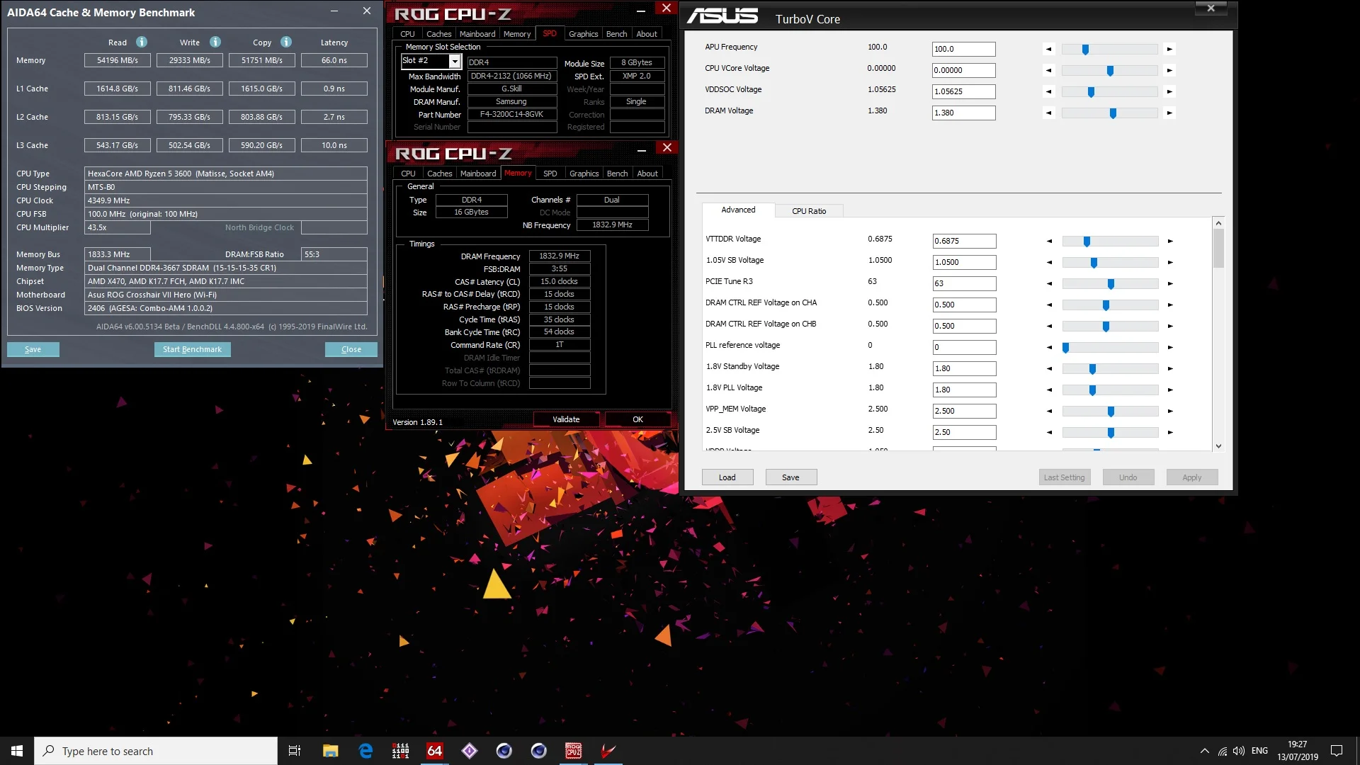

Seems like it from where I'm sitting. This ZIP has my current setup data, see the clocks in WMV. Last 6 screenies in this album show performance
