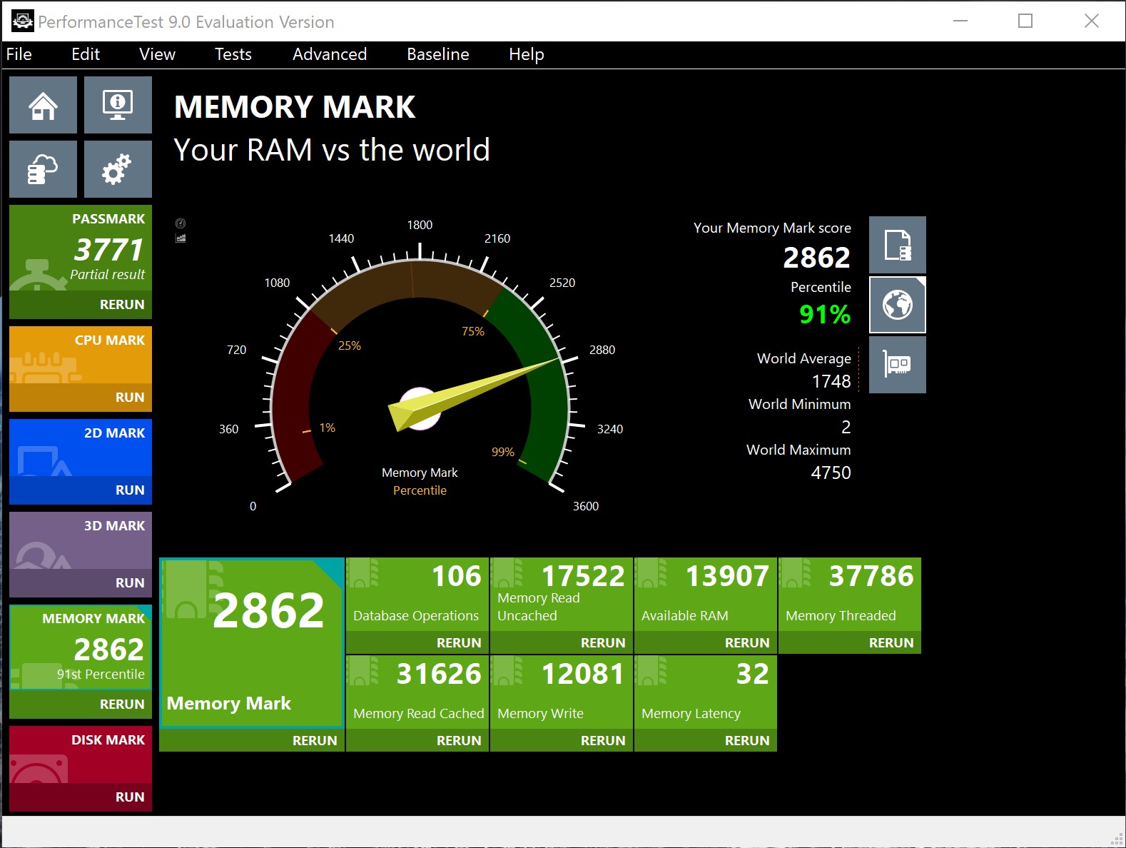

Here you go guys. My results fresh of the bench :D
As you can see, nothing special at all. Basically it is my my RAM running everything like XMP, but loosened tRas from 54 to 60 to stop getting errors.

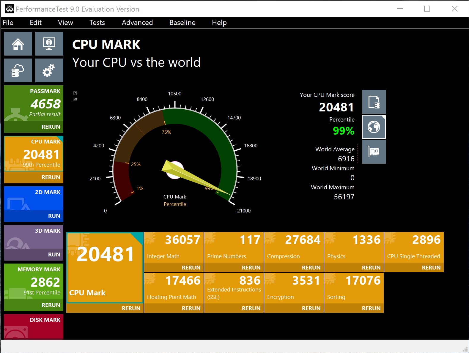

This is my CPU running at stock:

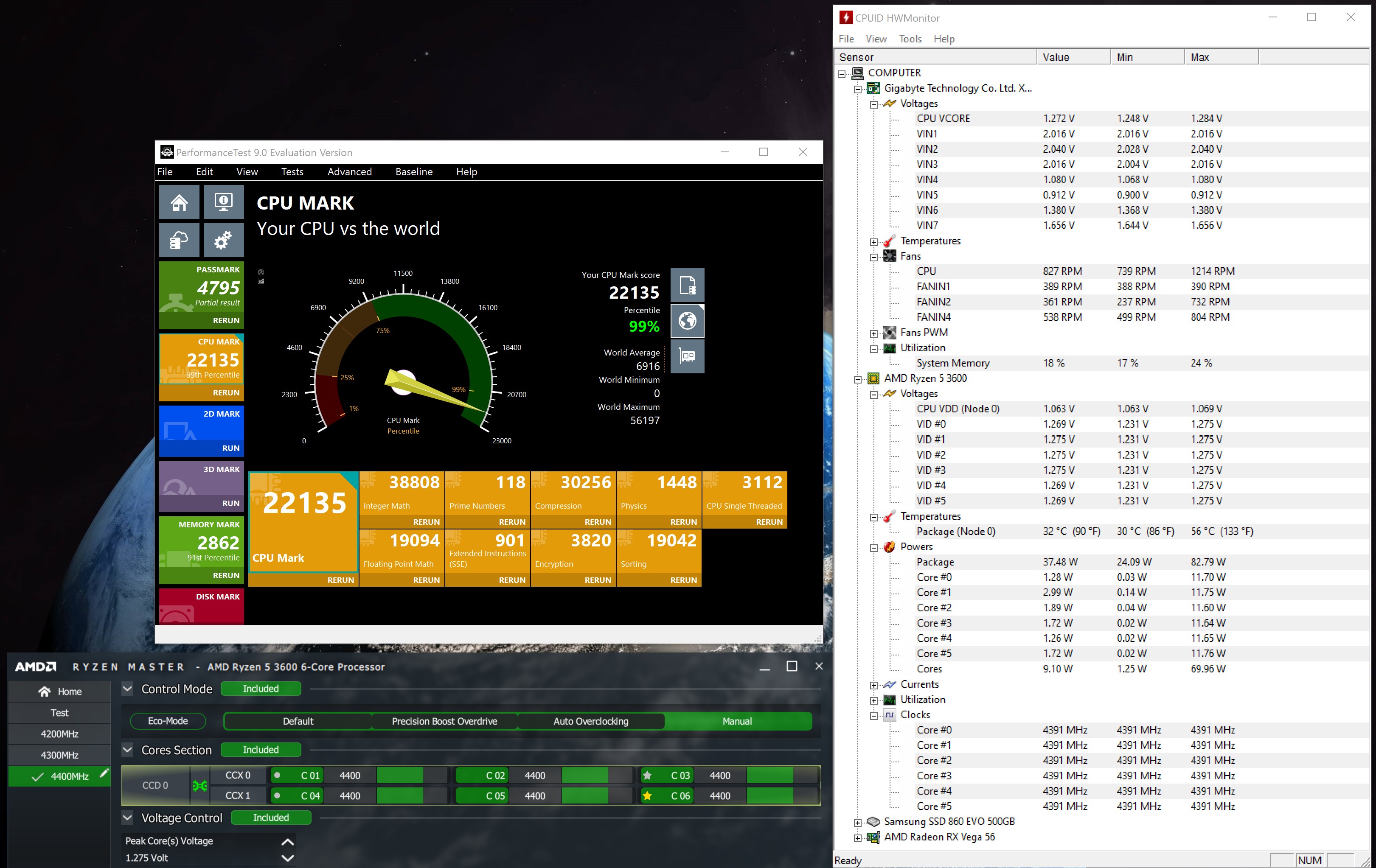

My 4.4GHz all core OC that so far has been stable:

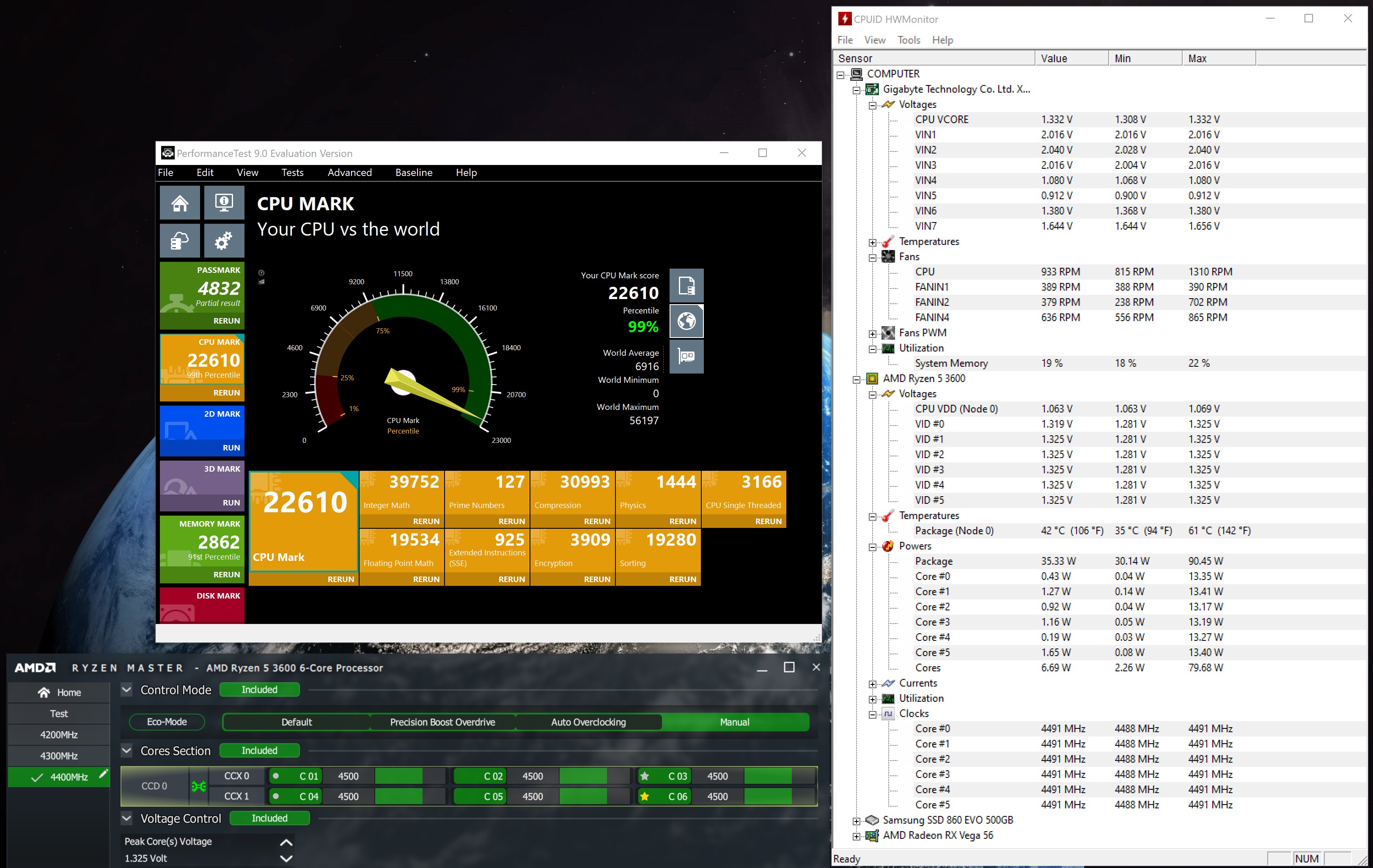

And for fun, a run at 4.5GHz all core, but I do not use this, nor have I tested it for 24/7 stability like I have my 4.4GHz OC.
My RAM score may suck a little, but try beating my CPU scores ;)
