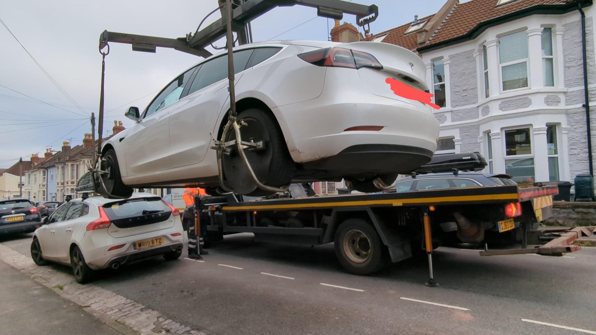

So it looks like my SR+ has completely died! Neighbour alerted us to the alarm going off so went to check it, got it but not even enough power to wind the driver's window back up. Won't turn on or reset etc, Tesla unable to bring it online from their end.
Had two errors overnight viewable on the app saying electrical system power reduced, vehicle may shut down, and then after that vehicle shutting down. Don't know at what time.
Now can't lock it or anything, window still ajar, so just waiting for a call back about a tow truck and a loaner. Fortunately I'm at home so not stranded anywhere but I am staying overnight 100 miles away tonight, supposed to be leaving in 2 hours, and it's just parked on the road.

Has it died because it was at a low charge when you left it or has something gone seriously wrong?
The latter. Was on about 73% when I parked it yesterday. Yesterday when I drove it for a mile or so from work I had to do a full power off and back on because I had a message saying it needed 30 seconds to power up before driving, but the message was persistent/car wouldn't go into gear for the 5 minutes I waited before that.
As it stands tow truck has already arrived but he's gone to replace it with a side loader because I'm parallel parked, got a Model S booked with Enterprise that I'm collecting in an hour, and £70 Uber credit in the meantime/to get to Enterprise.
Had three call backs from Tesla with updates and a direct email to the case handler.
Obviously no car should just 'die' overnight but that aside I can't fault the service so far.
Yikes, sounds like the 12V system has failed?
Yeah maybe. By the time the side loader came back I couldn't even lock/unlock it or get into it or the boot etc, totally dead.
They obviously felt the need to collect it though rather than doing a roadside repair/diagnostic?
Bye bye!
From reading, the 12v powers most of the system and the battery only lasts 3-4 years. If it does then the rear windows roll down. They are changing it in next year's model
Bye bye!
Out of curiosity why blank your number plate and not your neighbours!
