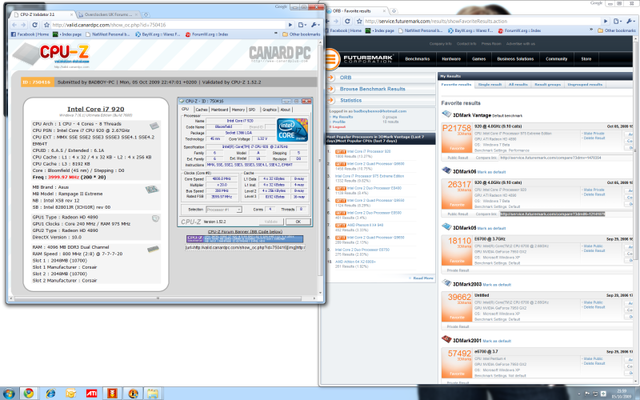

This is my first post following a friend recommending the forum. Given my new system and my efforts to get to 4.0GHz, I thought I'd post my settings
Motherboard = ASUS Rampage 2 Extreme
CPU = i7 920
Clocked speed = 4.0GHz
http://i40.photobucket.com/albums/e239/badboybenno/Untitled-2.png
Settings
CPU Voltage = 1.31V
CPU PLL = 1.92
QPI/DRAM = 1.35
DRAM = 1.64
BCLK = 200
CPU Ratio = 20
Memory = 1600MHz
UCLK = Around 3400
