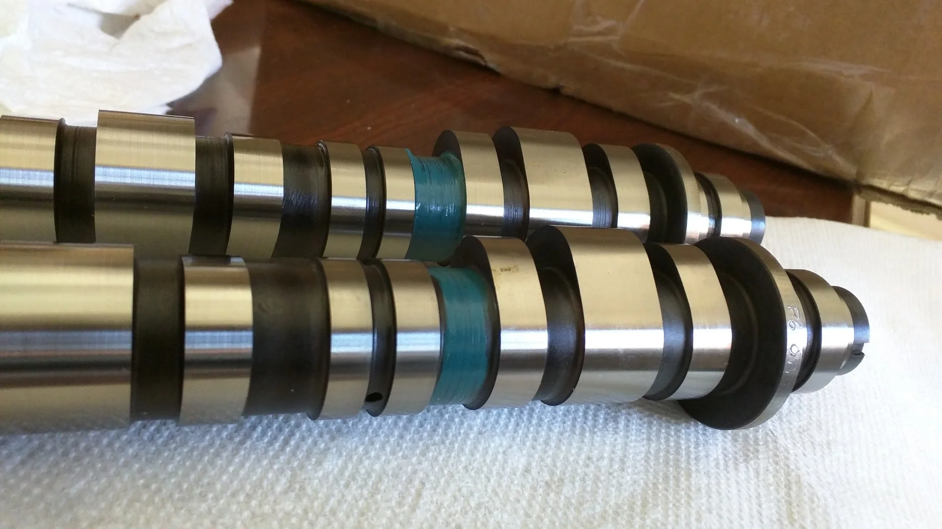

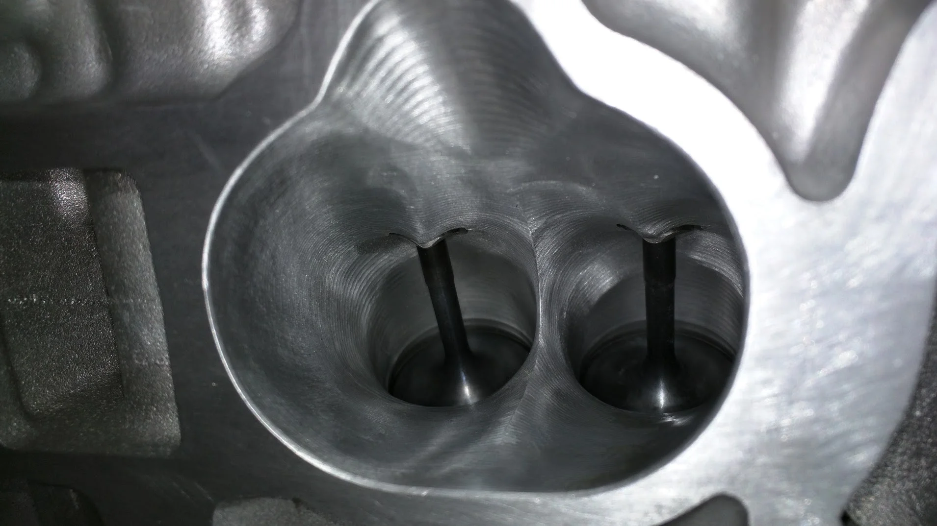

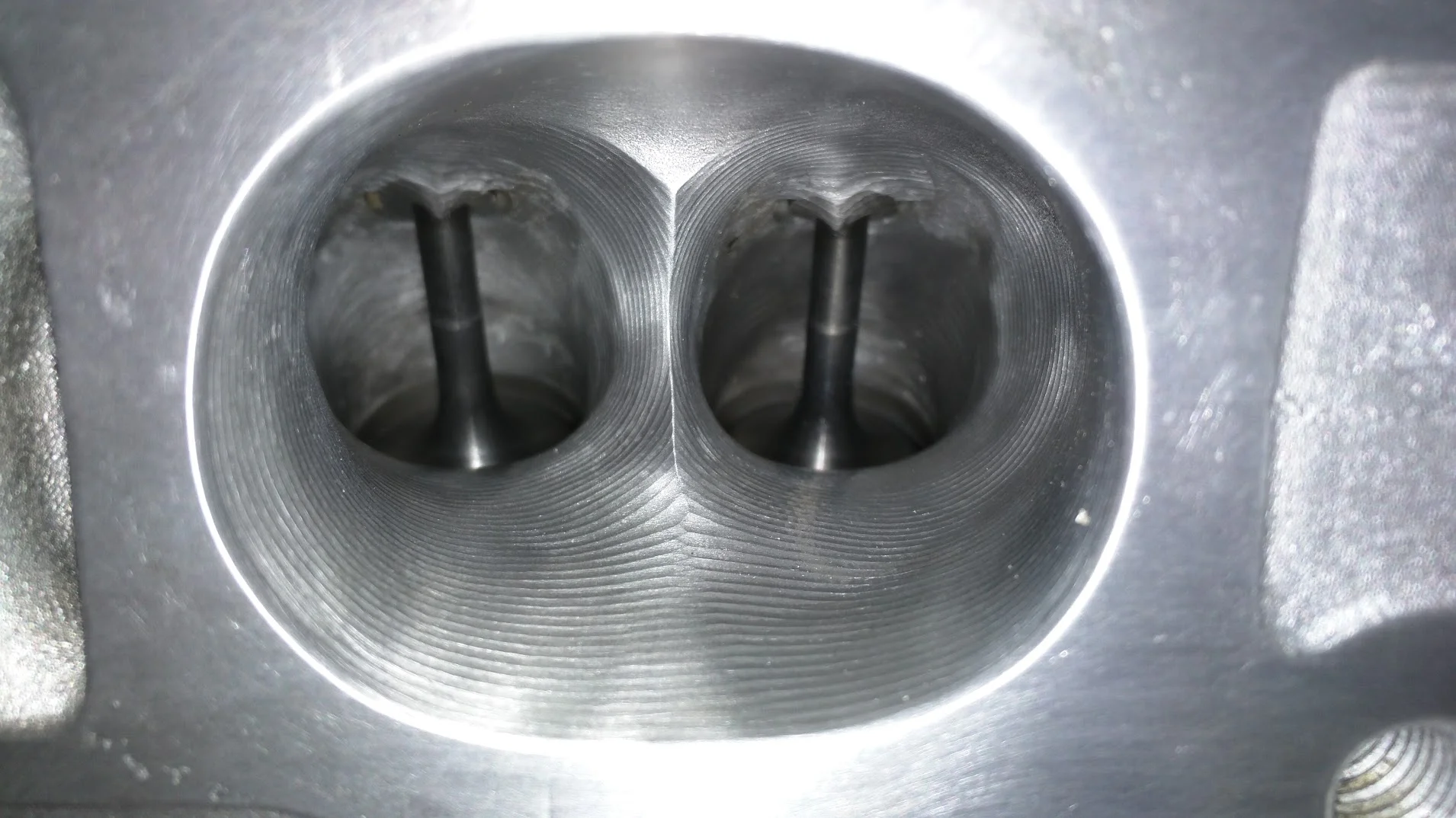

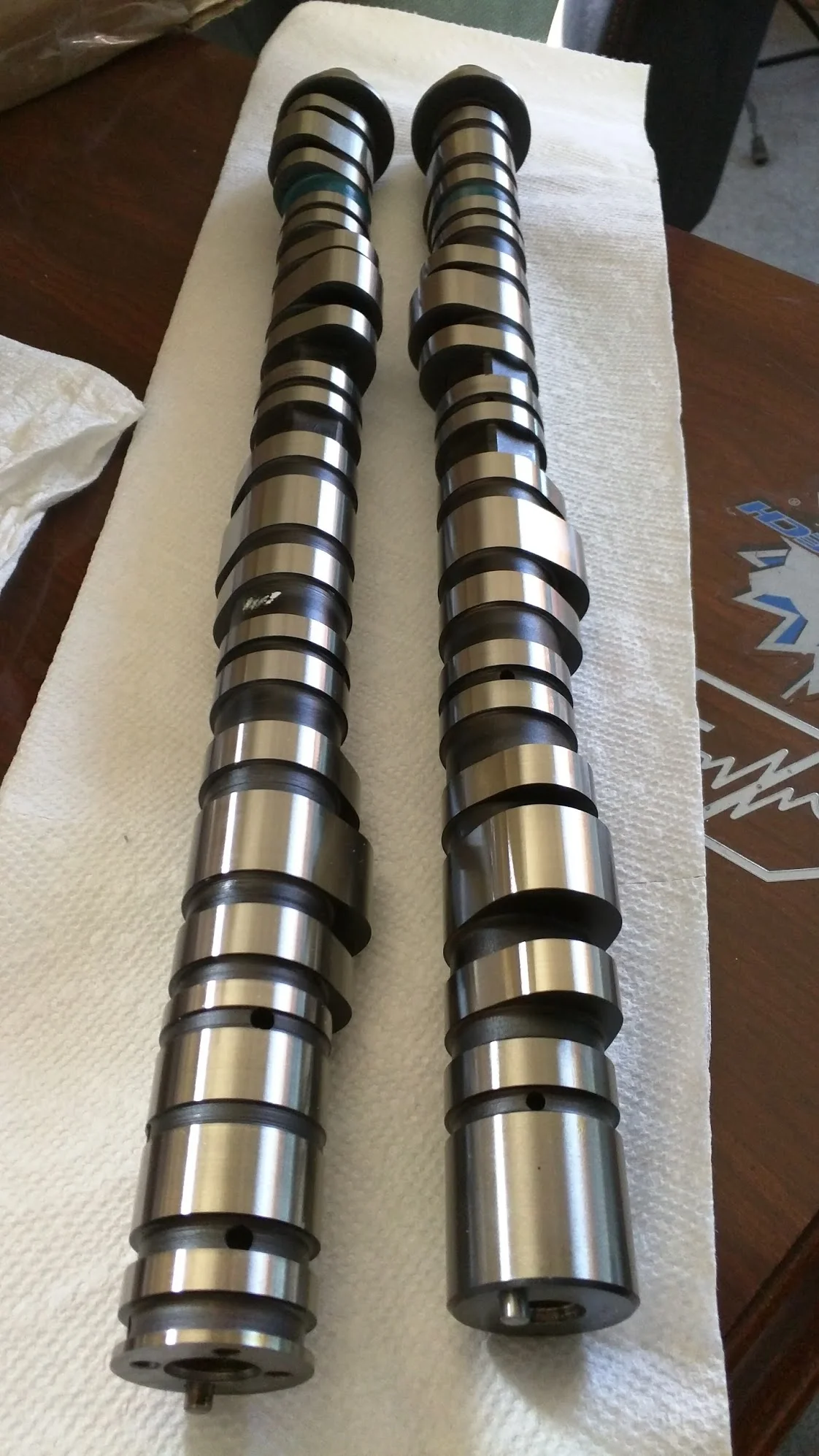

My vtec will definitely be going bwahh here soon lol. Building my little track queen k24/20. Going for the all motor track record in an 8th gen civic SI.
400cfm cnc ported PRB head just came in from Prayoonto. +1mm on the intake valves. Titanium springs / retainers.
Prayoonto Stage 6 3lobe cams. Lift .598"/.557" - 15.20/14.15
Should push close to or right at 400whp
Stoked!!!
