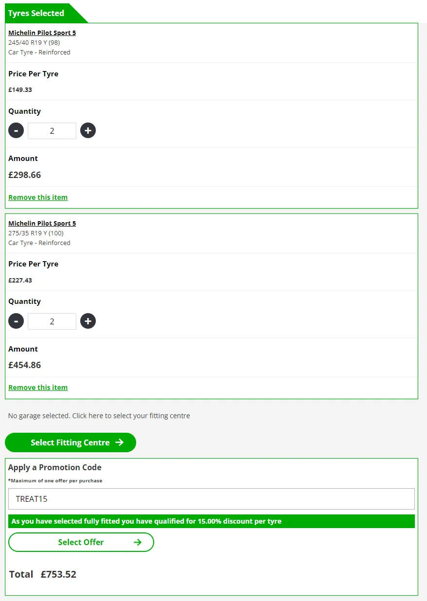

Still haven't bit the bullet on my tyres for the E43 - can anyone comment if their upcoming black Friday sale in November is worth waiting for?

Do I wait for Black Friday or do we think it'll just be the usual 15% flash sale they do?

So i ain't read everything here. But i have heard you can get like Pilot Sport 5's specific for Mercedes ? Is that right ?
Go on Blackcircles and enter your reg. I am looking for PS5 for my Mercedes but I don't think there is a specific Mercedes version.
