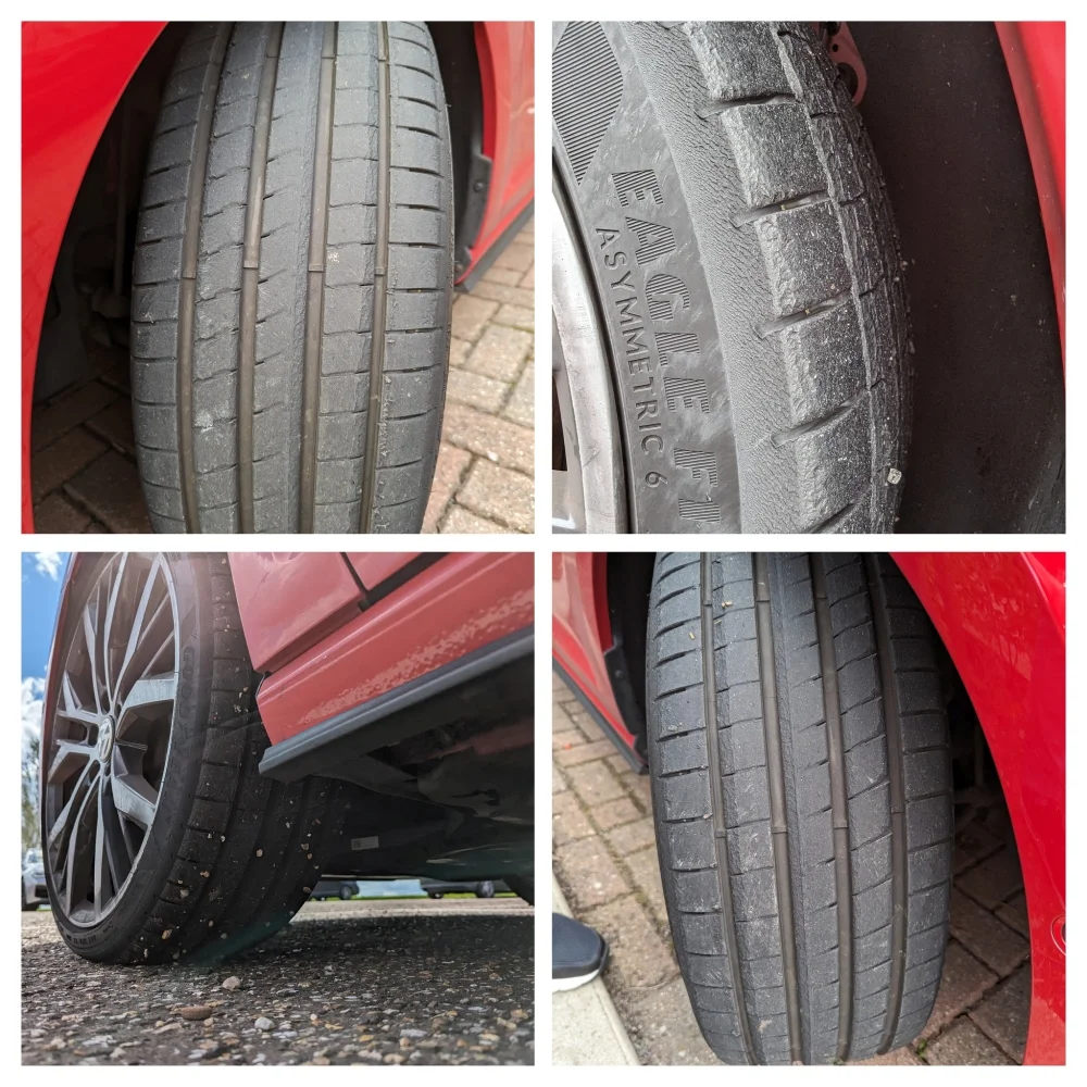

I eye balled it from this picture where it looked like an inch of sidewall. Does it look like 90mm?
Yes?
The 40 in the tyre size means the sidewall is 40% of the width of the tyre. So by increasing the width of the tyre by 10mm, you are increasing the height of the sidewall by 40% of that - so 4mm.
I would be amazed if you notice any ride quality difference with a change that small. Any difference you do notice is far more likely to be as a result of changing to a different tyre, rather than the size change.
