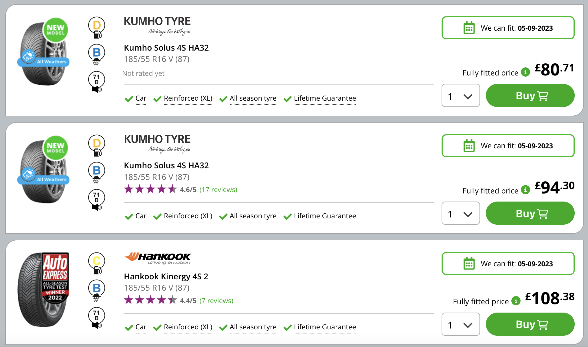

I recently took my Suzuki Swift for an MOT and I need to replace a tyre soon. I have very little knowledge about them so I had a few questions.
Current tyres:
NSF: 185/55R16 87V
NSR: 185/55R16 83V
OSF: 185/55R16 87V
OSR: 185/55R16 83V
1. Currently, the front tyres support different weight to my back. When it comes to replacing them, should I get the same weight or does it not matter wether I get 87V or 83V as long as they’re the same on the axil?
2. I’m planning to purchase and get them fitted through BlackCircles. Is it standard/expected that they will replace the pressure values or would I need to pay for that? How much should I expect to pay? They’re currently worn out with missing dust caps!
3. Out of these, which tyres would you pick?
A - Kumho Solus 4S HA32 - £81-95
B - Hankook Kinergy 4S 2 185/55 R16 87V- £109
Ideally you’d have all four the same, but in reality as long as they’re the same on each axle and not of very different quality/ character (i.e. winters on one and summers the other) you should be ok.
I’m not sure I’d be rushing to spend the extra £9 on hankook over Yokohama. They’re not cheap for 16” tyres. Any other options?
If you are only replacing one tyre, it needs to be the same as the tyre on the opposite axel, otherwise you will have to replace both, the tyre fitter won't charge you for filling it with air, it's part of the tyre change

I was hoping to get all weather tyres actually and so I've just realised that the Yokohama ones aren't.
There's also these Kumho but there's less fuel efficient and I'm confused about the difference between the top two results.
Not sure there is a difference between the top two. Strange that they’re different prices.
