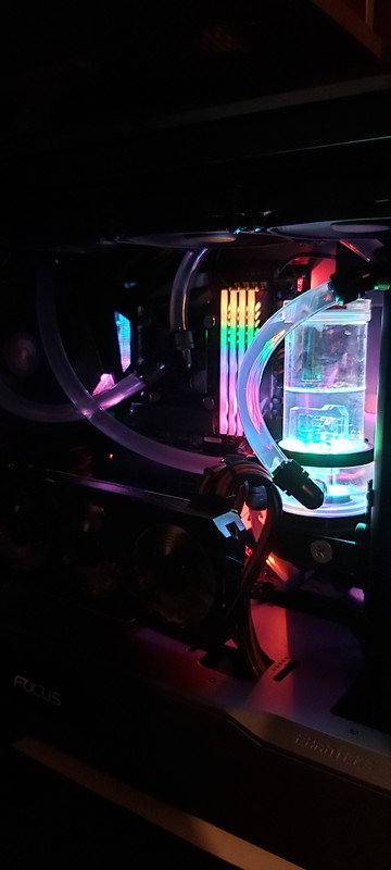

Yeah am worried about GPU temps with it being so choked off against the glass but will bench that tonight...how much of a space should I leave at the top of the res?
Usually I leave 2 inches
Every day or so for a little while
You should crack open top port on
The res to release air
Though not sure if you can or not
Looks very tight
One reason I like a top fill port is
Easy to let air out

Looks great. Once you have that new GPU and block being close to the glass won't matter diddly squat.
Going to be a delay in final pictures until it goes dark and I get the Fiancee's proper camera out as my potato phone camera just can't seem to catch it in a good light.
So I've emptied about 2 inches out of the res, I'm understanding now why I was struggling to fill it past the metal tube. As that's about 2 inches long, I had to open another port to fill higher. Doesn't state that in the manual though so without you guys I could have come unstuck I think.

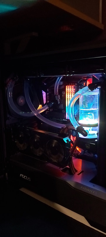

Okay so idle temps are roughly the same, maybe a couple of degrees lower but fluctuating. You may recall though that with the Silent loop 360 I was running I couldn't run P95 Small FFT's I'd start the test and instantly hard lock and bsod maybe catching core temp instantly hitting 100c if I was quick enough.
Well being the complete and utter sadist I am I ran it... There was a sudden spike to 98c on 1 core with the rest getting no higher than 93c but the moment the fans ramped up temps dropped suddenly back down high 70's low 80's and ran it for a good hour before getting bored. Repeated the test with the loop running full pelt and I didn't get higher than 79c after an hour. It's amazing watching the fluid move so fast though when it's really getting hammered. I'm going to monitor while gaming etc but so far I'm incredibly impressed.
Only issue I'm having at the moment is I'm now paranoid and constantly checking for leaks lol

Ah gotcha now about the metal tube
You don't fill it down that
If you do it's likely to fountain out
The top :p
What it's for is if your return /in
Tubing is going into top of reservoir
Then sending it down the metal tube is fine as its got the pump pressure
To do it:D
And the tube sends the coolant under
The level in the reservoir
So no splashing/waterfall noise then:D:D:D
So best I can do for you guys with the phone, I'm no photographer by any stretch!
@Mcnumpty2323, @Space Monkey, @Awahwah Thank you for all the help and advice I really appreciate it and wouldn't have gotten through it without you guys!
very good photos for a phone mate

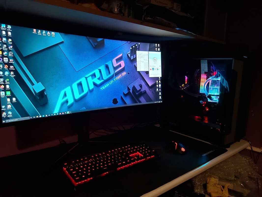

like the auros wallpaper
you get that from gigabyte site?
2nd edit lol
i just cant spell aorus correctly
2nd edit lol
Yeah it's a really bright res, I honestly never thought I'd say I need more RGB but definitely want more now lol
I want the RGB water block and some decent rgb fans when I next upgrade...Just don't know which ones.
Yeah I think I got that paper off of the Gigabyte site, though I tend to just search 4k wall papers on Google and go from there.

So my gpu doesn't like being choked off temps hitting 80c easily when gaming, still thinks it's weird my fps is so much more stable though not that I'm complaining.
