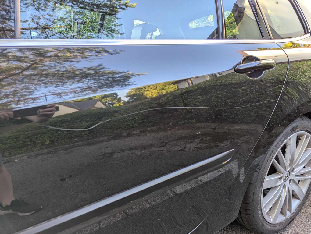

Picked up an 'old banger' a month ago for workhorse duties and put it straight into service. Haven't even had chance to post it on here before the local yoofs made their mark on it... literally
Bonus points if you can guess the car...
My daily banger is although mechanically sound, the paintwork is abused to the point I wouldn't notice key mark like this. The joys of having a £500 car that you don't give a single F about. :D
