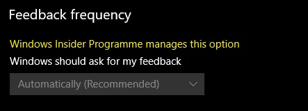

Just updated with no noticeable issues, but there is this under diagnostics & feedback:
I'm not in the insiders programme so why can't I turn this off :confused:?
No worry, everybody get these too. Insiders received patch from Windows Update fixed that issue updated build to 10.0.17134.5.
So far no new updates from Windows Update yet so maybe there will be updates next week on 8 May 2018.

Thanks. Hopefully it'll get patched soon then.
I've uninstalled the Feedback Hub app anyway so shouldn't get prompt by them :p...
