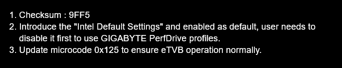

Finally, thanks to Gigabyte for allowing me to join the rather non-elite, but seemingly crowded, Intel gimp club....
I feel honoured, my CPU feels mightily cooled, and my RL has now regressed back to the performance of my 9900k.
Awesome time warp experience.

Try under volting your CPU. You should retain most of the performance.
I have a negative offset of -0.13500v and my Cinebench R23 score is around 38.5K vs 40K ish when running on the unlimited mode (I only ran this once just to see the difference).

Thanks.
I am yet to use that default function. My RL 14700k runs fine with an offset of -0.05v. That seems to be the most stable. I can't remember which of the content creators it was who noted that whilst an offset is helpful, it can't prevent the CPU from, at times, demand high vcore voltages. Perhaps I have that explained incorrectly, as mine is "only" an i7 14700k the issues noted have not concerned me in terms of its running.
