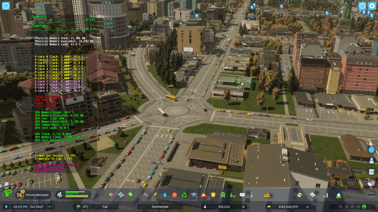

I do not know much about that game but Cities Skylines 2, has its own issues, seems to utilise the e cores quite well...
Bigger and clickable picture here.....
clickity click
I do not know what it would mean if the e-cores were disabled. Civ VI seems to also utilise the e-cores. With some other games tho they largely remain inactive, in terms of noting the game utilise them much.
clickity click
