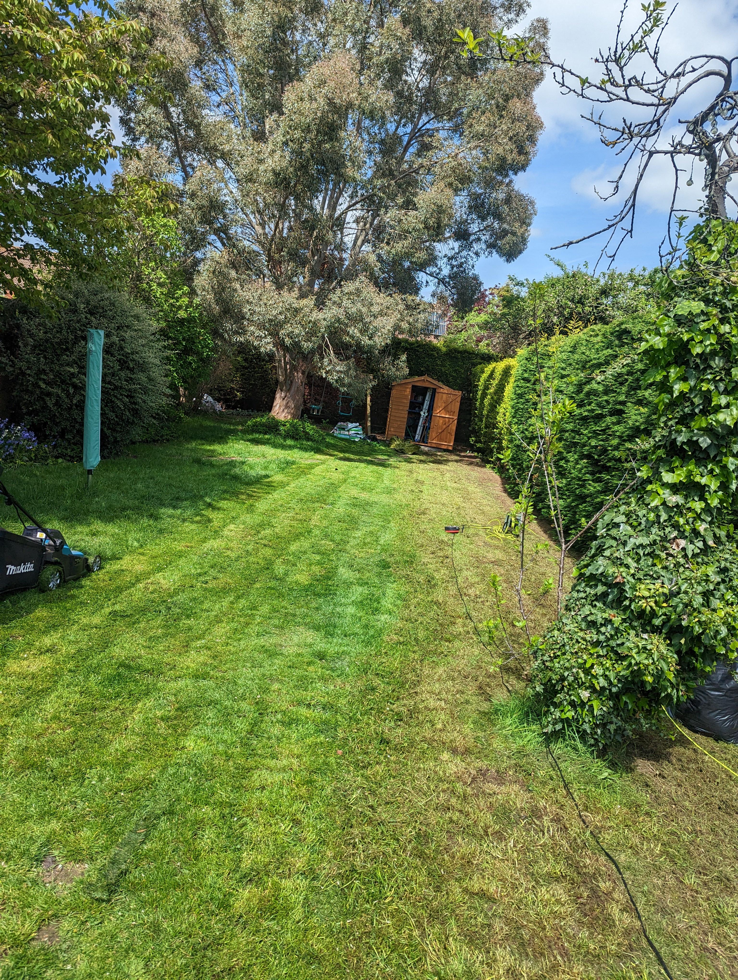

I reckon Im gonna build one about 2.7m height (and 1.8m away from boundary line). So it SHOULD require planning but to be honest my neighbours won't actually be able to see it
I could submit a planning application but there's a 12week determination period and I'm going to start in 4 weeks (I have 3 months paternity leave :D)
Reckon I'll be reet? I think I'll chance it.
P. S. how solid do you think the ground "piles" are>? my concern is I'll have a lot of tree roots but I could just adjust
Im gonna go around 8m wide X 3.5m deep in the back section taking up most the back swing/shed area in the picture above.
