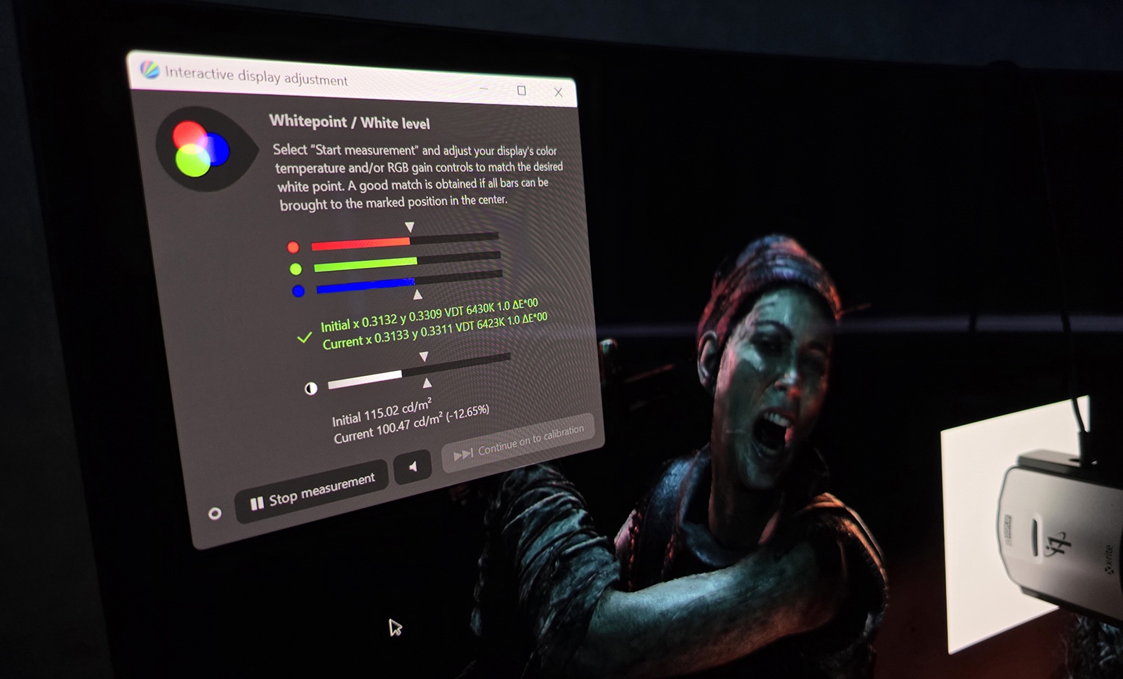

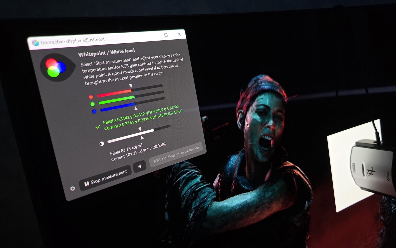

Alright so done some measurements and well, this thing is insanely accurate in both Standard and Creator mode. It will merely come down to individual preference on more vibrant RGB or more neutral RGB. Both modes adhere to accurate 6500K factory target. The brightness setting in the OSD solely comes down to how comfortable you find the brightness and doesn't affect the colour accuracy.
For baseline I set DisplayCAL to "As measured", so it shows exactly what's being read. A Spectral profile exists for this display in the global DB so I used that dated this month which is handy so was confident in the measurement from the i1Display Pro.
Standard mode (brightness 54 for a 100cd/m2 target):
Creator mode (brightness 44 for a 100cd/m2 target):
Creator mode is obviously the closest to 6500K^ but Standard isn't far off considering it has slightly boosted RGB vibrancy.
Until now I had just eyeballed the brightness as I always had all monitors calibrated to a 100cd/m2 target, so I'm happy my eyeballing was on ball with the previous 42 brightness value in Creator mode only being 2 hour which gave about 92 cd/m2.
I think we have reached a level with QD-OLED now that they are so well calibrated for accurate colour work out of the box that manual calibration is merely a trivial "let's just see how good it is from factory" task :cry:
