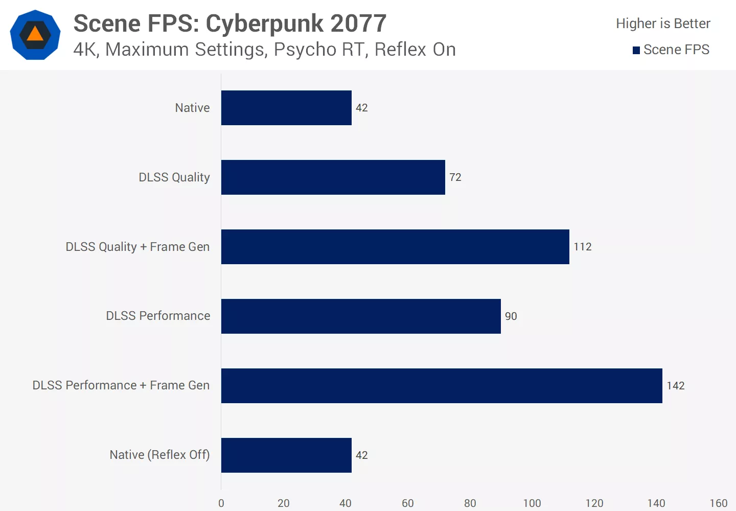

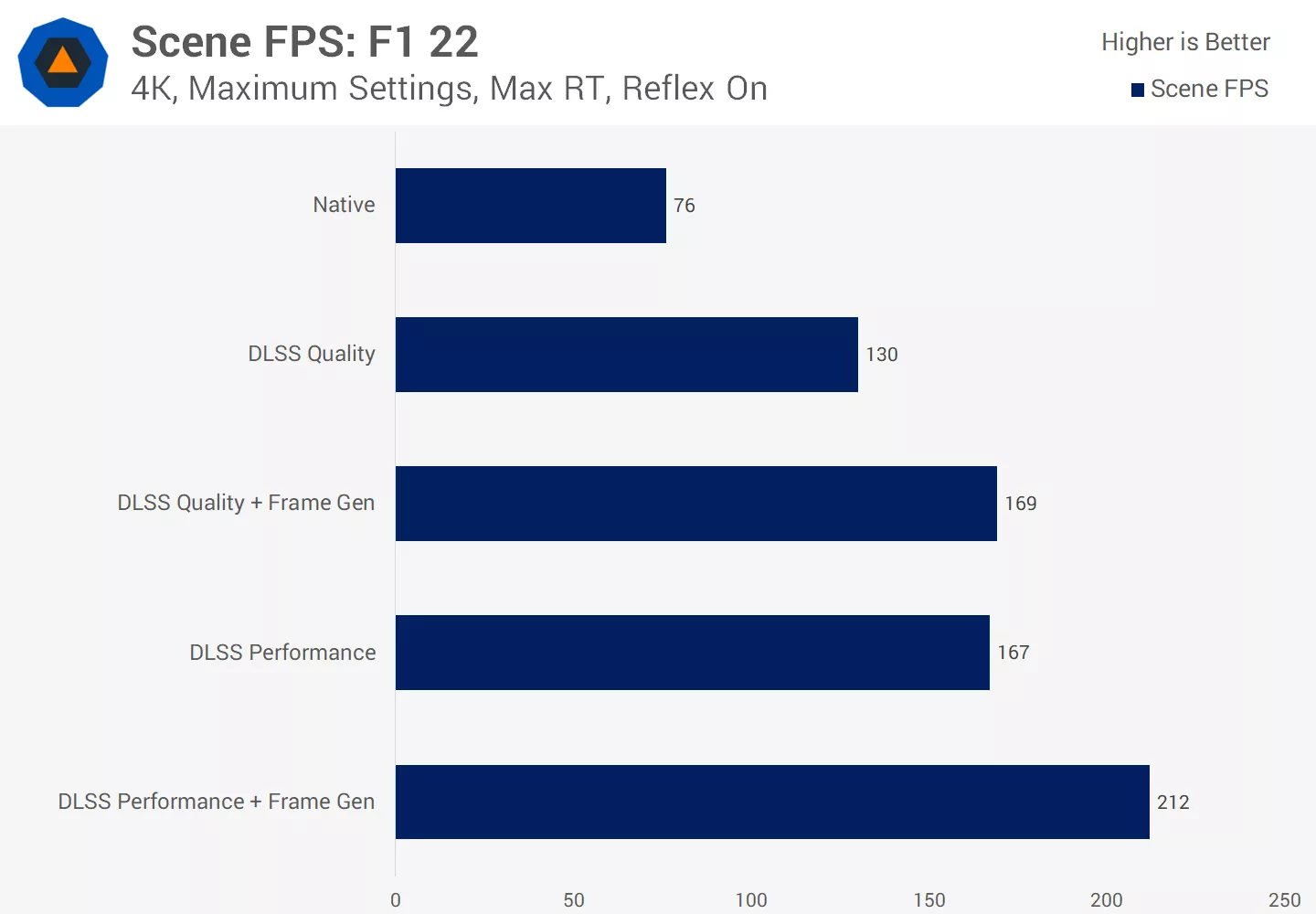

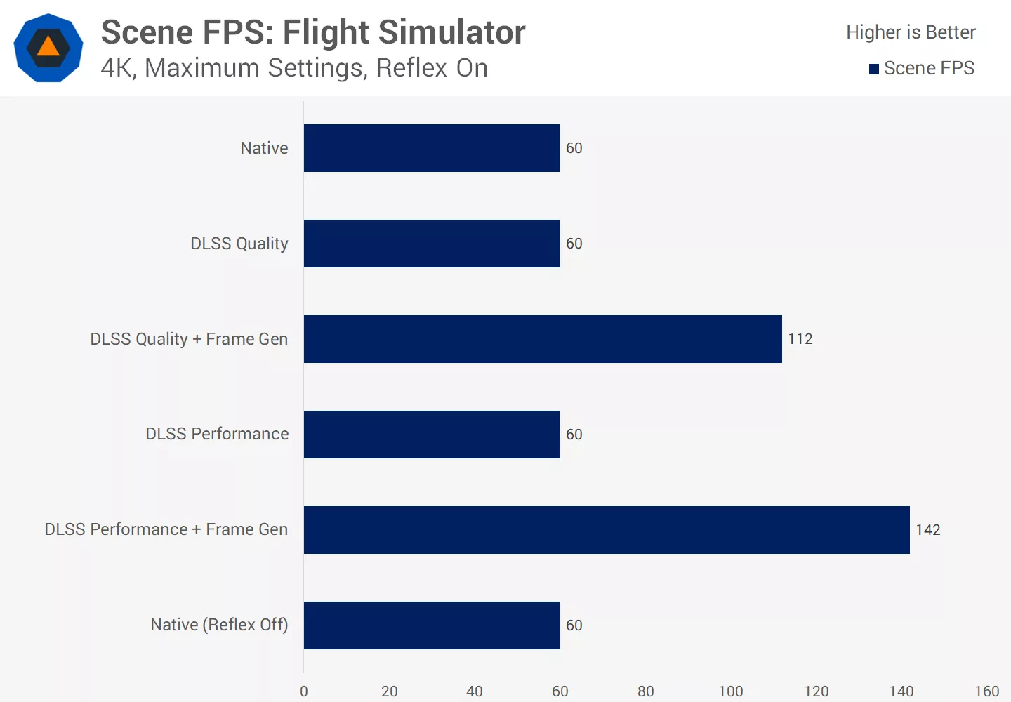

You'll see here, no game is more than double for DLSS3 vs DLSS3 FG.
The only game that actually gets close to double is flight simulator, which is possibly the most ideal game for frame interpolation due to everything being slow to change.
So when people post videos of FSR3 mods getting more than double the performance (or even double), either the interpolation is doing very little, or they are literally just repeated frames with next to no interpolation. Should leave it to the developers instead of kidding yourselves.
