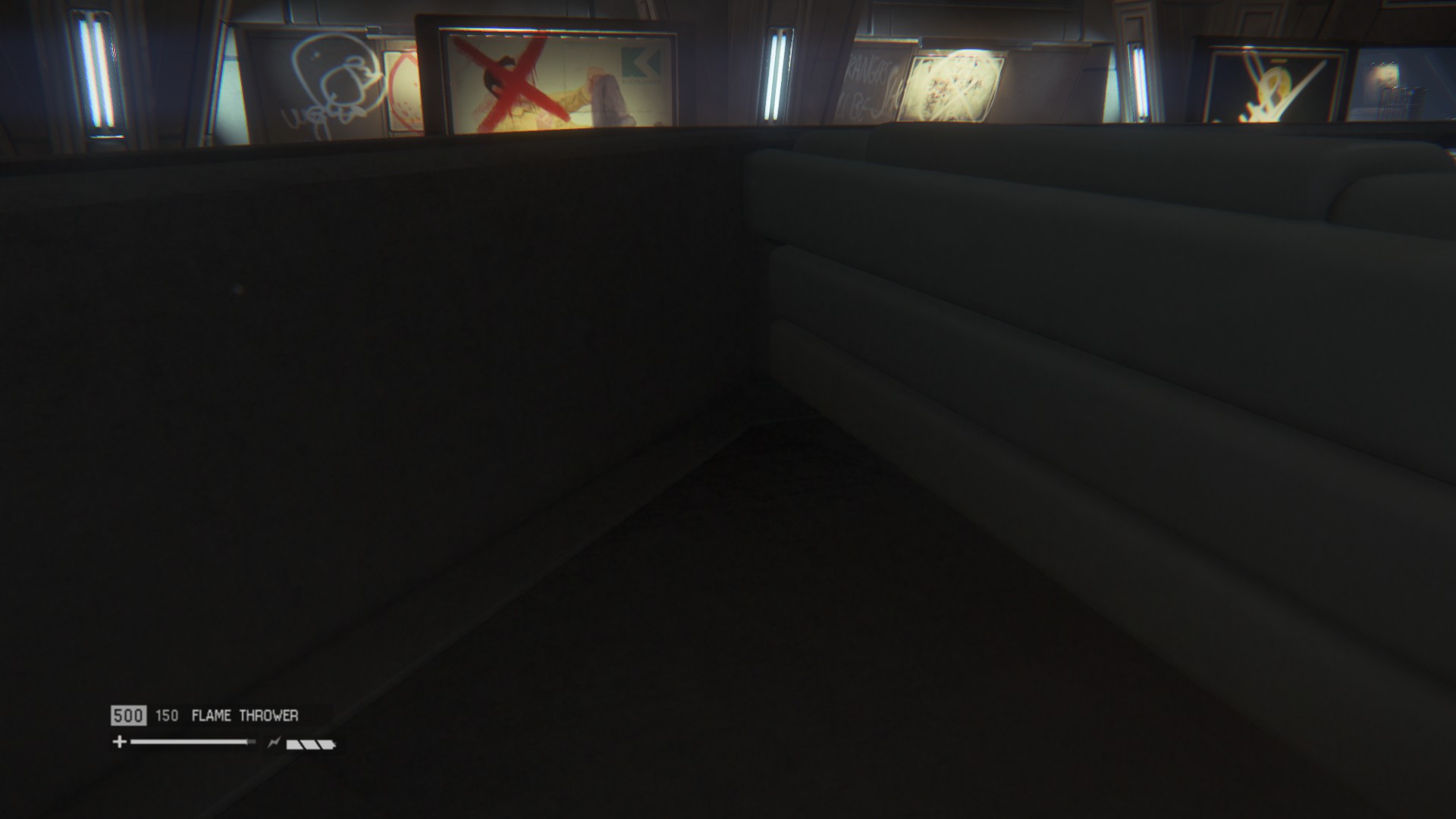

I have done a fresh install so need to download more games to test. If anyone with this monitor has Alien isolation can you see what the dark/black areas in game look like? on mine it looks blocky/pixelated.
i have tested alien isolation for you, freesync enabled and fullscreen in game. no corruption when alt tabbing, however the monitor looses signal for a moment and then presents the desktop. when alt tabbing again the game is then displaying fine. i tested this a few times.
in regards to the darker areas, i can also confirm that these appear blocky/pixelated.
