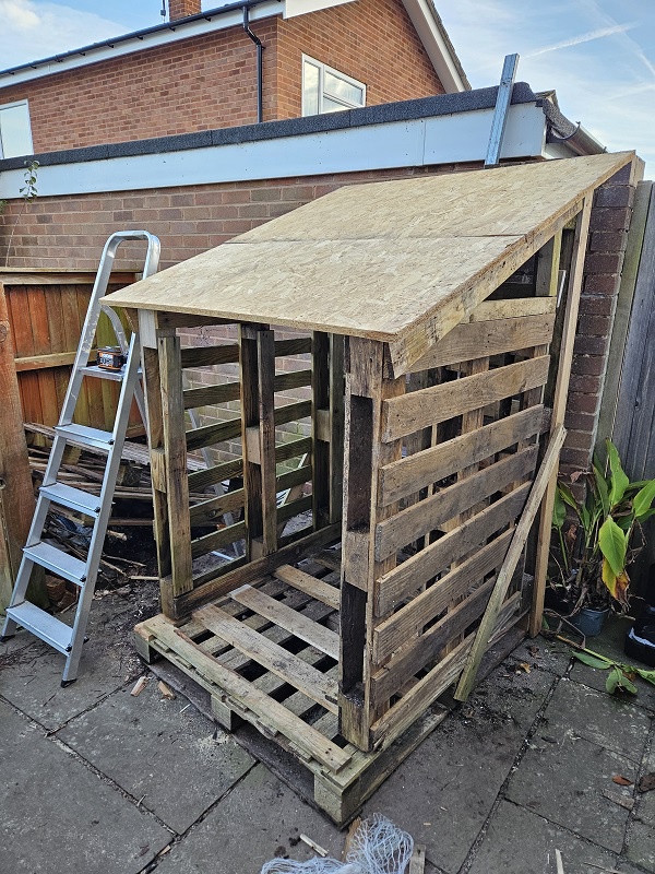

Back in summer 2023 we had new radiators which came on a pallet with a basic frame over the top... https://forums.overclockers.co.uk/t...axes-chainsaws.18907528/page-15#post-36456941
I didn't get around to it then... Nor this summer (lol), but finally got bored of staring at it and made into a wood store last weekend... Nothing too grand, but all scavenged wood from 'off sized' pallets free from work (!), some chipboard left over from when we had builders in for the roof, felt I had left over from a bulk roll purchase. Door hinges from some in the toolbox (no idea - very old B&Q label), so think the only expense is going to be a latch for it. Even re-used a bunch of nails I'd pulled out of 3 pallets I broke up for some more side slats, then screws which I guess I bought at some point. Even have a serviced&fixed padlock ready for it! Maybe something to treat the wood with, then have some fence panel stain/paint stuff left over can use to colour it! #budgetstore :cool:
