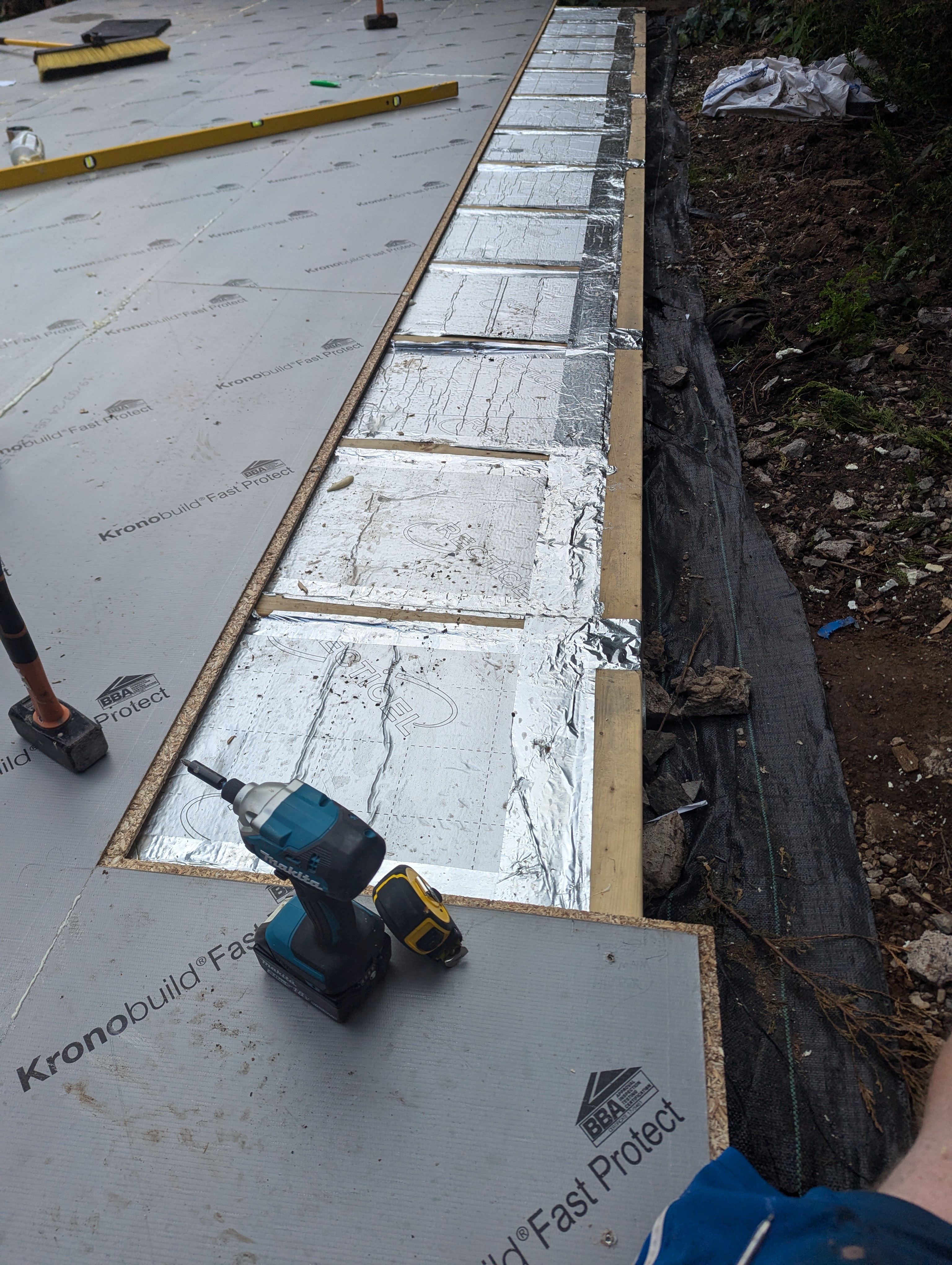

@dlockers did you cut your boards flush with your frame or allow a small overhang to stop the OSB clashing with the wall?
Looks like to stop a clash would need a 2cm or so offset if that makes sense. But realise with walls over 2.3m and 100mm floor beams the 2.4m OSB probably won't hit it anyway.
Not sure I fully get you - my OSB is flush with top of wall, and extends about 5 inches passed the end so it overlaps the bearer/metal washer.
Extra 10 on doors is worth it. The 1950 ones I've got are noticeably low. Not ducking height but not far off lol.
Yeah I thought generally the whole idea seems a bit low for internal head height to be honest. I guess it's so the people selling them don't need to block themselves with planning but if doing DIY can either sort the planning or take the risk.
I'm talking about this overhang of the floor sorry, how much past the floor is yours? (if at all?)
Ah gotcha! No more than maybe 1.5-2cm max. Didn't want the wall being too supported by floating 22mm lol.
