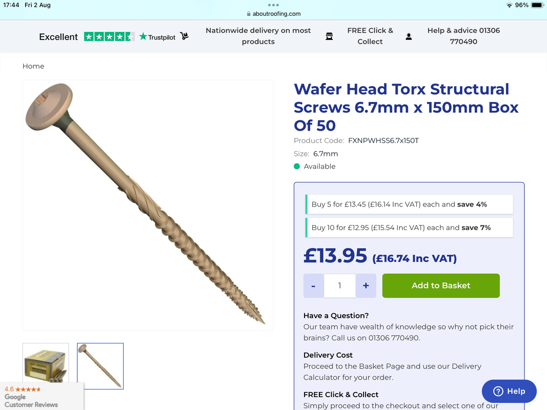

Just get some 150mm structural screws and screw up from below, its more than enough and will negate the need for hurricane straps. As for the steel, either strap or drill a few holes and screw in from there…… ive used structural screws for my pergula build and its been fine for 4yrs now in some pretty strong winds up here on the welsh mountains.
£14 for 50 structural screws…….
I put the roof beams in today and there's multiple 100mm screws (4 to 6) in each beam. Should be fine.
