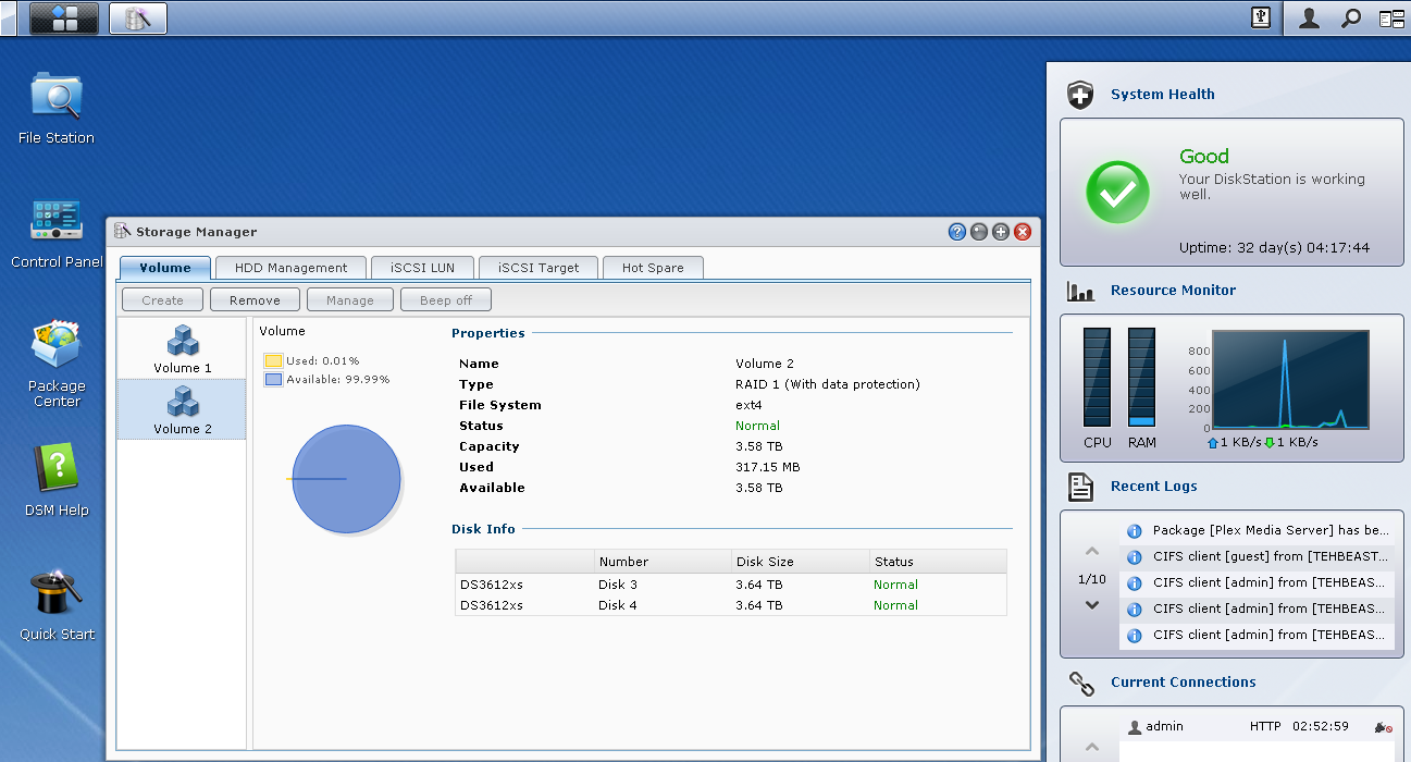

Hello knowledgeable peeps :)
I come with questions and a request for help
I have XPEnology running on my N54L with a pair of WD Greens (I know :S) in the RAID set up through the control panel.
Im looking to add two more drives (WD Reds :) ) and have a few queries:
1) Can I add the two new drives (in RAID) without affecting the other RAID setup or losing any data
2) Does it matter that I will have a mix of dives (Red and Green) even in separate RAIDs ?
Thanks muchly in advance :)

Im back !
So, HDDs arrived today and installed fine:
And the existing Volume 1:
So, next question (sorry) is when i look in File Station or Windows Explorer I can only "see" one volume ?
How do I go about "seeing" and differentiating between volumes to choose where I save files and able to swap and copy between Volumes ?
Thanks again
