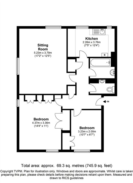

Hi guys,
Might you be able to offer advice as to how many LED fixtures my flat renovation might require?
I'm wanting them in the hallways, the bathroom & toilet and the kitchen. I think I am set on 6 in the kitchen, 4 in the bathroom and 2 in the toilet.
Where more of a question lies for me is in the hallways, which are approximately 3m in length from the front door to the larger bedroom and approximately 4m from the kitchen to the smaller bedroom. The hatch to the loft is in-between the front door and the junction of the hallways which makes things more awkward.
At the moment this space is served by just 1 light fixture, which does not provide the even lighting I would like. My impression from being in the property is that 3 evenly space fixtures; one in the hallway from the front door and two in the hallway to the kitchen might do.
Can anyone advise or offer information as to where to find the optimum LED fixture separation distance?
Ta
Hi guys,
Ta
