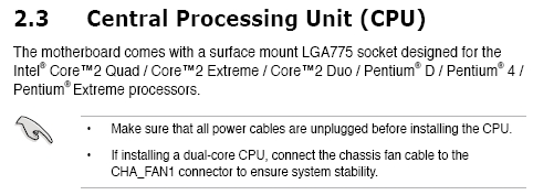

I see from the manual that you have to plug the CPU Fan into the CHA_FAN1 connector if you are using a dual core cpu, I take it that this is also the case for Quad cores.
If I don't plan to use QFan is this stil necessary?
Yes, same for Quads also.
Hi, huh, does it and where in the manual, as far as I know all CPU fans plus into the CPU_FAN. It is the option fan that can plug into the CHA_FAN1, which of course you don't need...
Chris
This what I saw in the manual but it now I re-read it seems to imply that that as Lt Goody says it is talking about the chassis fan and not the cpu fan as I first thought.
