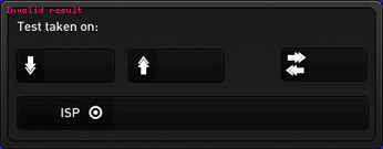

shouldnt I be getting a higher upstream on the speed tests? That one is the highest I seem to get between the different servers, and BT's gives me 32/7 :(
