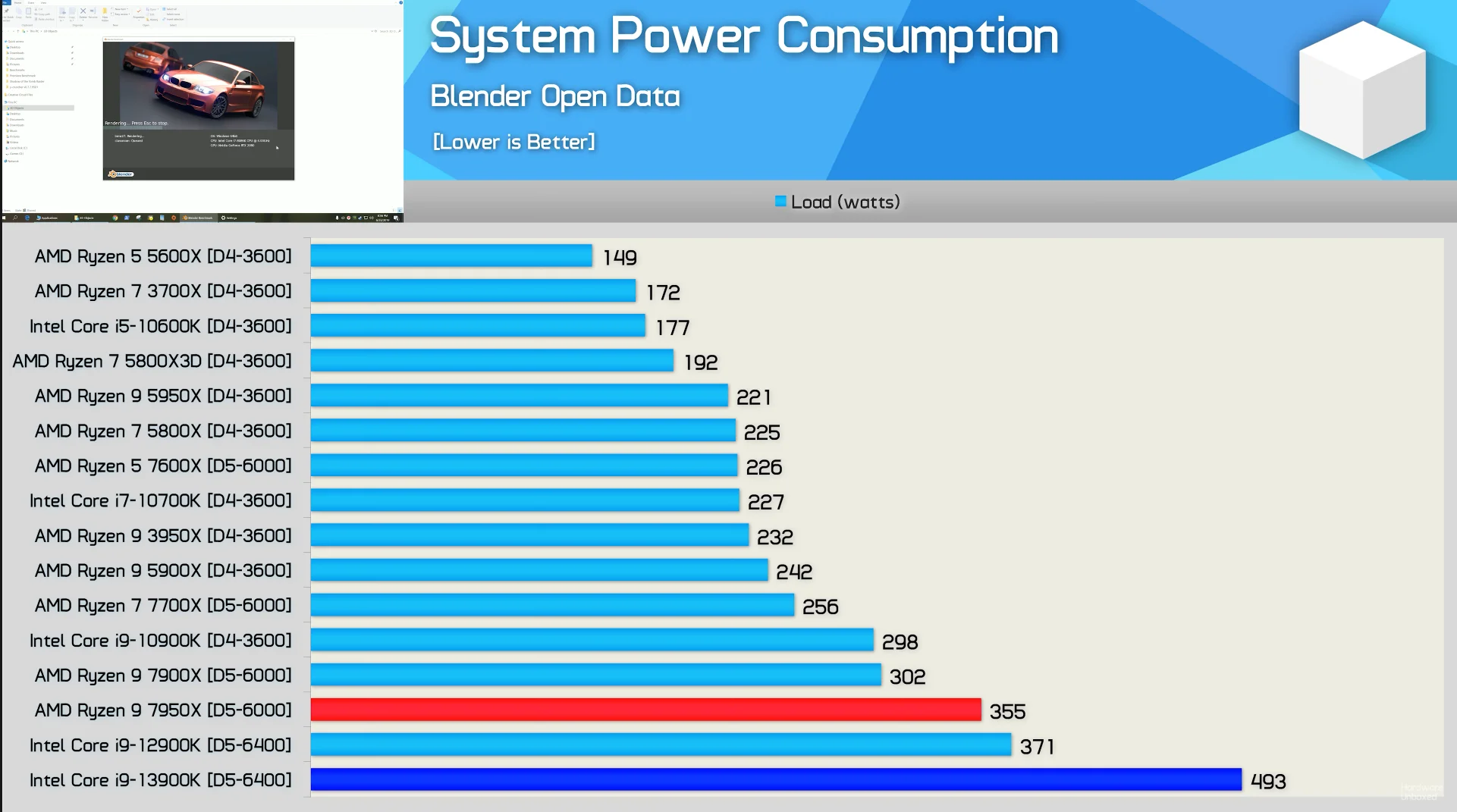

Watched a few reviews and performance numbers look pretty good. Power consumption / efficiency are laughable but it's not a bad product as a balls to the wall must be fastest product. The big question is where the hell do they go from here? They don't have a more advanced node unless they push production to TSMC so they will be relying on small incremental improvements on the Intel 7 node or they will need to throw more power at it. I'm much more interested in what happens next gen now to see what they do as more power at this level doesn't seem to be the right approach so performance needs to come from somewhere else.

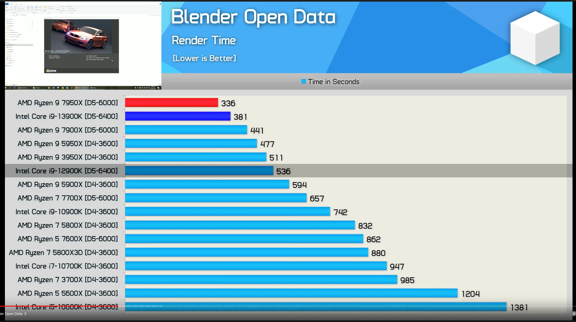

So after watching a few different reviews the take away seems to be that the 13900k beats the 7950X in most workloads even when set to the Intel limits which is 250w vs around 220w for the 7950X.
The 13900k is cheaper than the 7950X, motherboards are also cheaper and you can reuse your old DDR4 for even more savings if you wish. The board and CPU saving alone negates the advantage of AM5s upgradablity and it would likely cost no more buying a 13900k + Z690 then buying a 14900k + Z890 than it would buying an X670 + 7950X then buying a 8950X.

Really? Everyone (besides techpowerup and techcspot I guess) have the gains at over 40% at 253w stock. CBR23 is spot on at 43%, but 7zip for example shows bigger gains.
Im seeing what up to around 16% ish single threaded and averages bar some outliers of up to around high 20's to early 30%'s over a lot of workloads. I dont think its right to pick a single workload and say "look its 40% faster" when across a lot of workloads its more like 25/30% faster MT and sort of somewhere between sort or 10 to 20% on those single thread numbers. These are great results tbh but it's not really representative to call it 40% faster at the same power draw.
Wizzard at TPU gets 40k if he turns MCE on but with it off and respecting power limits he gets similar to Puget.
Which doesn't make sense - cause if he was thermal throttling as you mentioned, turning MCE on wouldn't change anything. He would still be getting the same score. TPus numbers are just off man
Im sorry, maybe I didn't make it clear. Im talking about heavy MT workloads, not ST or mixed workloads, of course in those I wasn't expecting a 40% increase, that would be absurd. But anything that stresses the CPU , it's 40% at minimum faster than the 12900k. Which is very impressive - at least to me. With that said, id still go for a 7950x if I only cared about MT

Ιm sure the graph with the 13900k pulling 400w from the socket is legit. Im sure the chip won't self destruct trying to do that. I mean come on...there is no freaking way you believe that, you are just fanboying. Four hundred watts? LOL

Jay says that all MB boosting stuff is turned off for his testing and the cpu consumes 253w and runs 82c, he says with it turned on it hits 95c and 350w.

Jay says that all MB boosting stuff if turned off for his testing and the cpu consumes 253w and runs 82c, he says with it turned on it hits 95c and 350w.
Lol that's impressive only 95c at 350w was that 350 w for 5 seconds lmao
