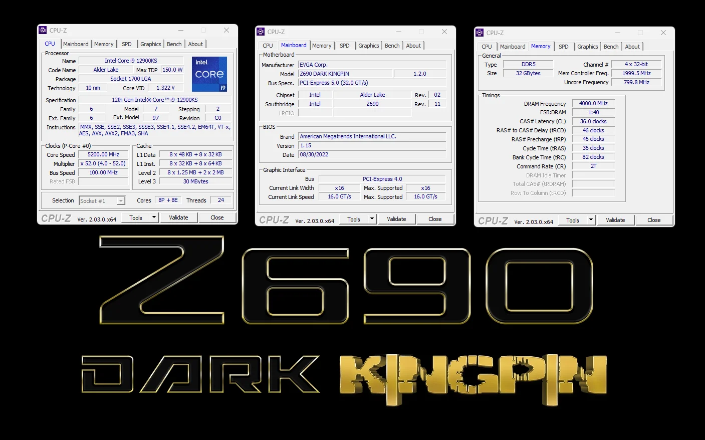

That was a quick test on my Dark.
Looked at this again, tightened up ever so slighty. Results came back a little better than the first run. But i have zero improvement over my standard bracket. I had a feeling mine was fine but i had to mess with it anyway.
