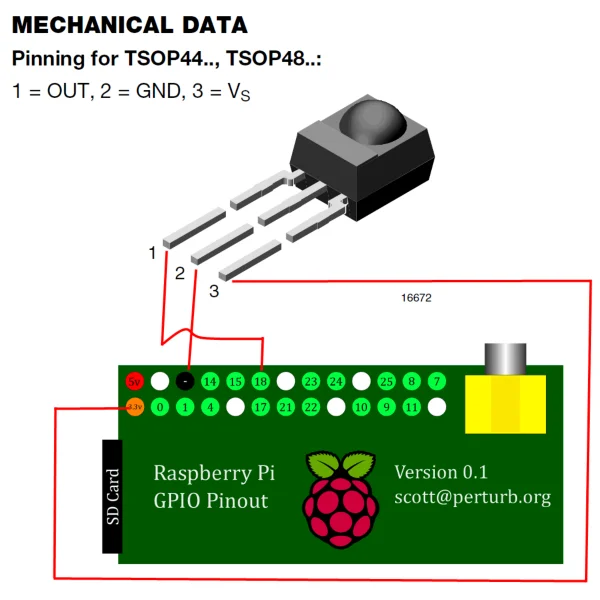

True but CEC on most remotes has limited control, I simply un-soldered the IR from a faulty xbox 360 mobo (they can also be bought from the bay for £1-£2) and then connected to the Pi via the GPIO pins (no usb needed).
The M$ (or fake r6) remote gives you more control within xbmc straight out the box.
(If you are recycling the IR from an old faulty 360 then it needs 5v supply instead of 3.3v (GPIO pin 2 or 4 instead of 3.3v pins 1 or 17))

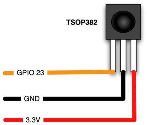

Why didn't I think of that... Just thrown away 2 broken xboxes. I'm guessing most IR receivers will work, like say from an old satellite/dvd/freeview box?
TSOP4838 Vishay Photodiode , IR Receiver , 38Khz
Bought one of these off the bay, should come in a few days will I need to do anything for openelec do you think?
