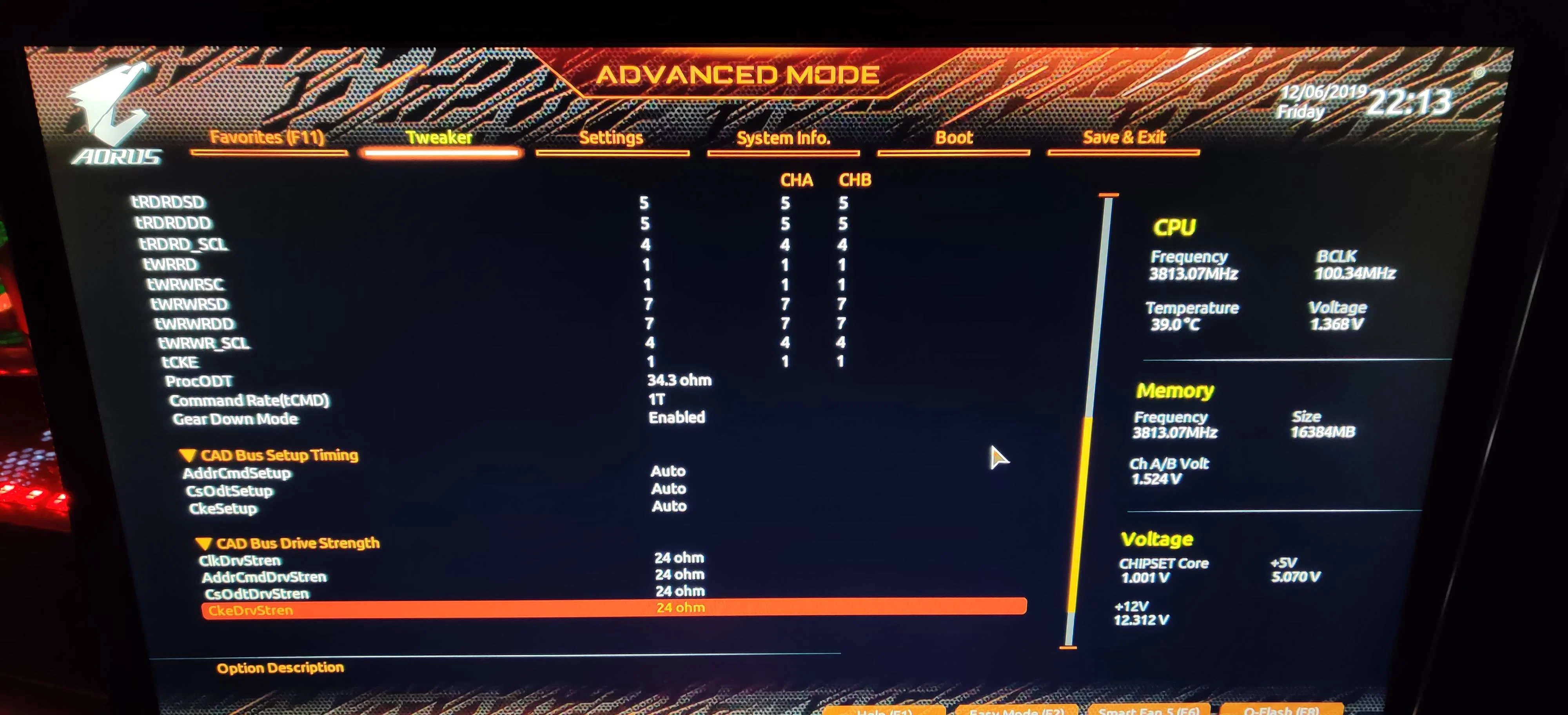

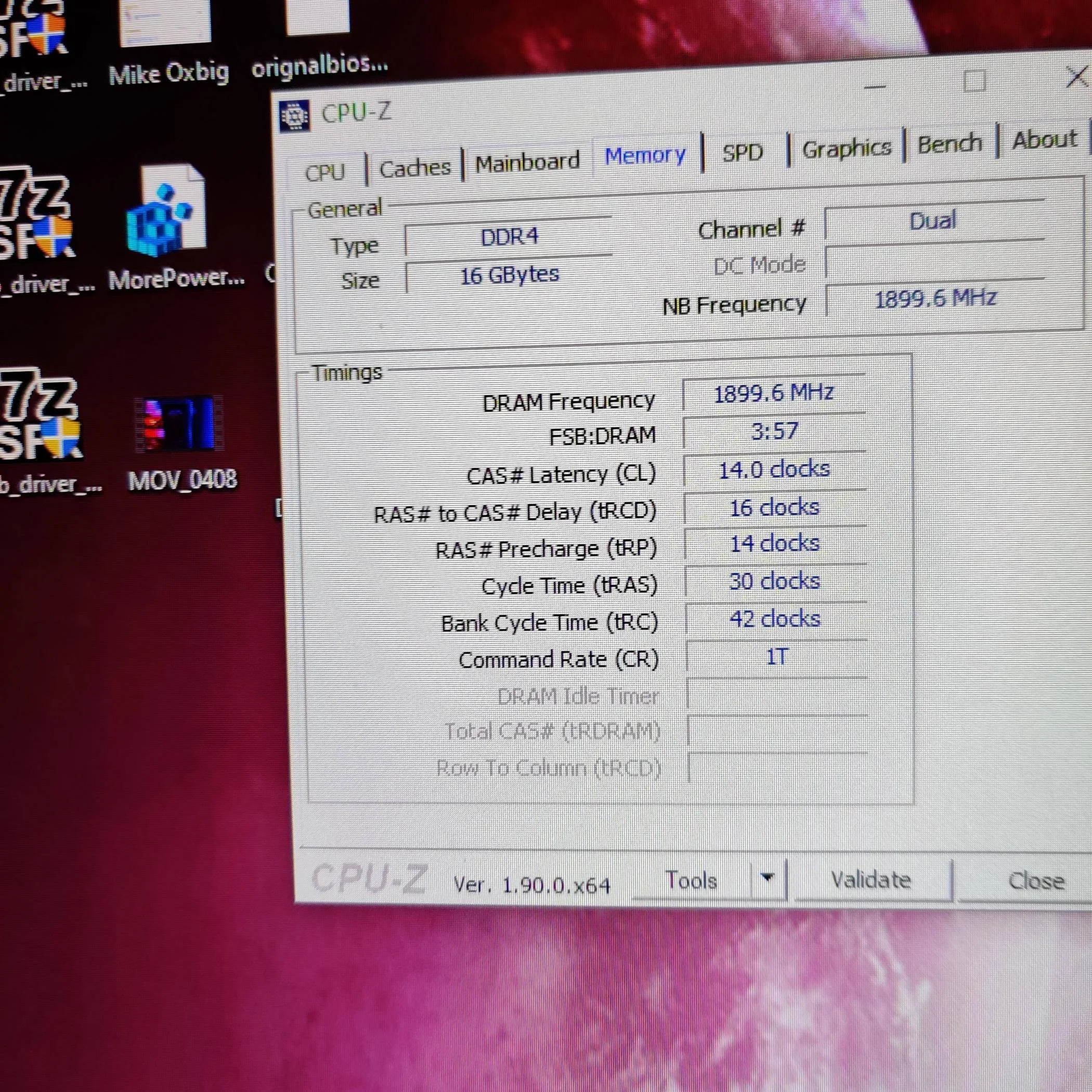

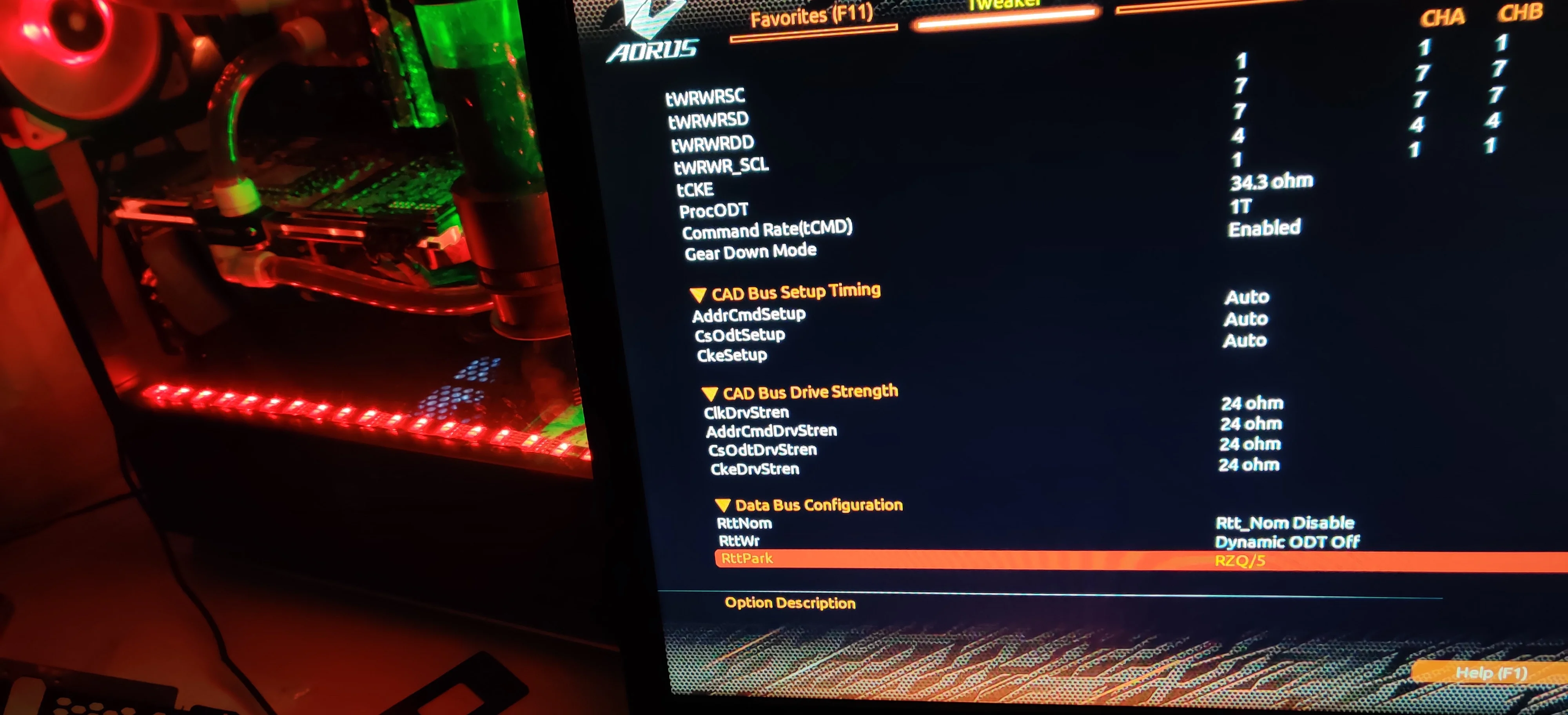

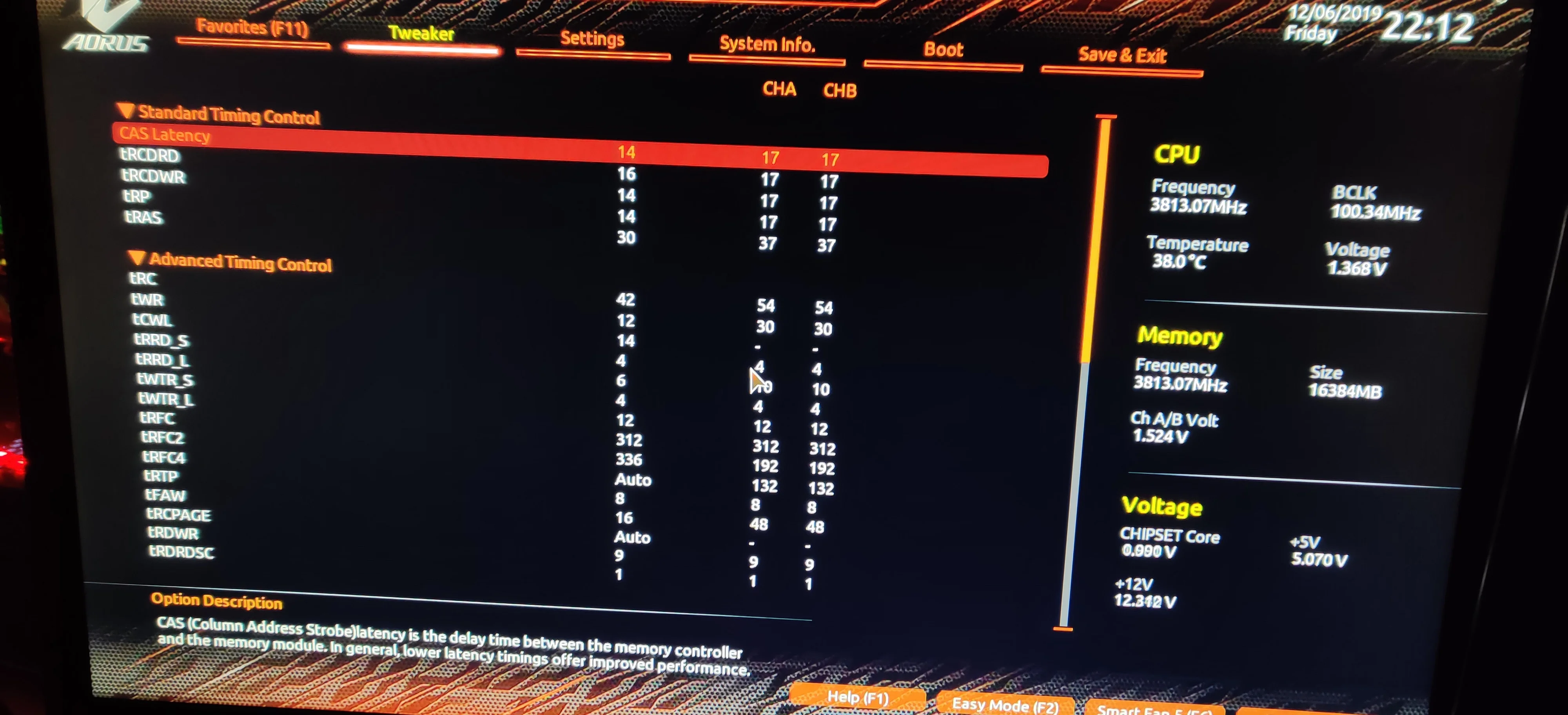

Many thanks for taking the time to post this up. Apart from the DRam voltage at 1.5v did you change other voltages like S0C?Yes but that is my settings, numbers don't age
That should be every setting, the ram is set to 1.5v
Yes soc is at 1.125 I think the vddc and the other one are at 1.010Many thanks for taking the time to post this up. Apart from the DRam voltage at 1.5v did you change other voltages like S0C?
