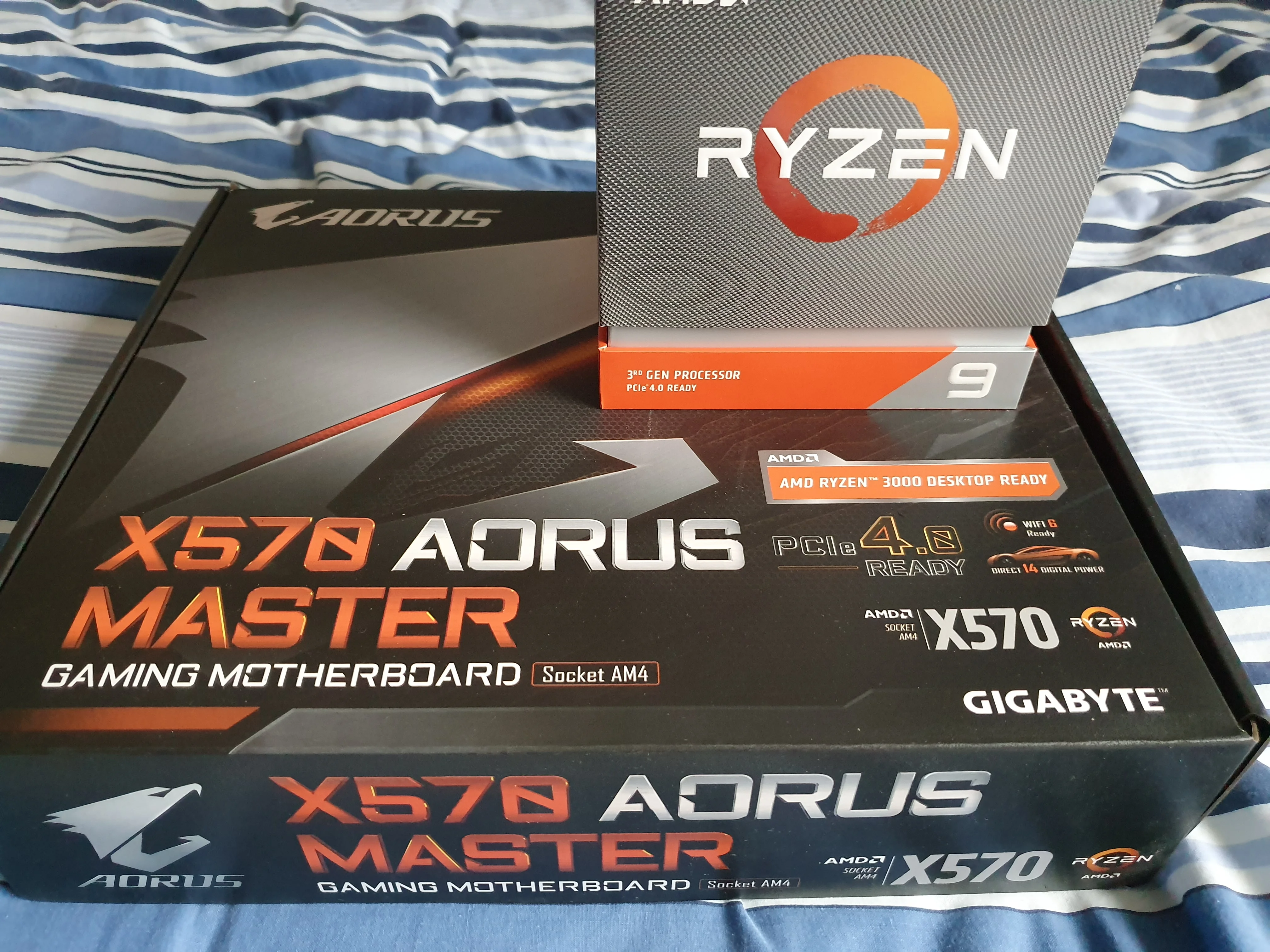

So excited to start my new build with these two as the base :D
