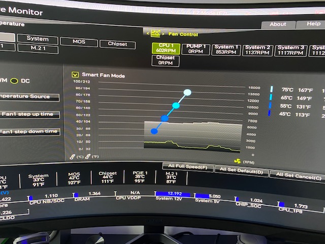

Ok not sure if I'm being thick here but I've set the CPU fan curve in the BIOS at the following:
But the fan is still ramping up and down in windows, it appears the power plan settings are overriding it? Something I'm missing here lol
Hmm. That's an odd graph. Is there an option to change the mode so you can actually have temp on one axis and rpm on another axis. That graph is a nonsense advertisment graph of perhaps some default mode?

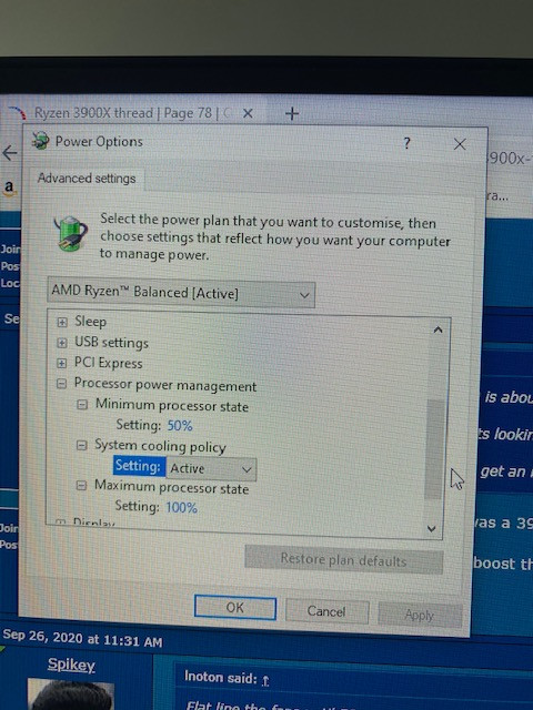

Windows might be able to override if you have some fan control sofrware installed. Uninstall all that personally :-) that is a personal preference though, but they will conflict so pick on or the other.
I don't have anything else installed. What should the processor states above be set to? Only thing I've got is corsair icue but that's just for LED fans.
I'd have to check later, but tbh I don't think that should make jack difference to the fan profile.
The graph has no X axis? So reading it the rpm increases as the temp does. No other options?
This is full image. It appears to me that the power plan settings are ramping the fan up and down. So if I change max setting to 99% it stops but then my CPU won't boost properly. Driving me insane. Seems to he overriding those settings in BIOS.
