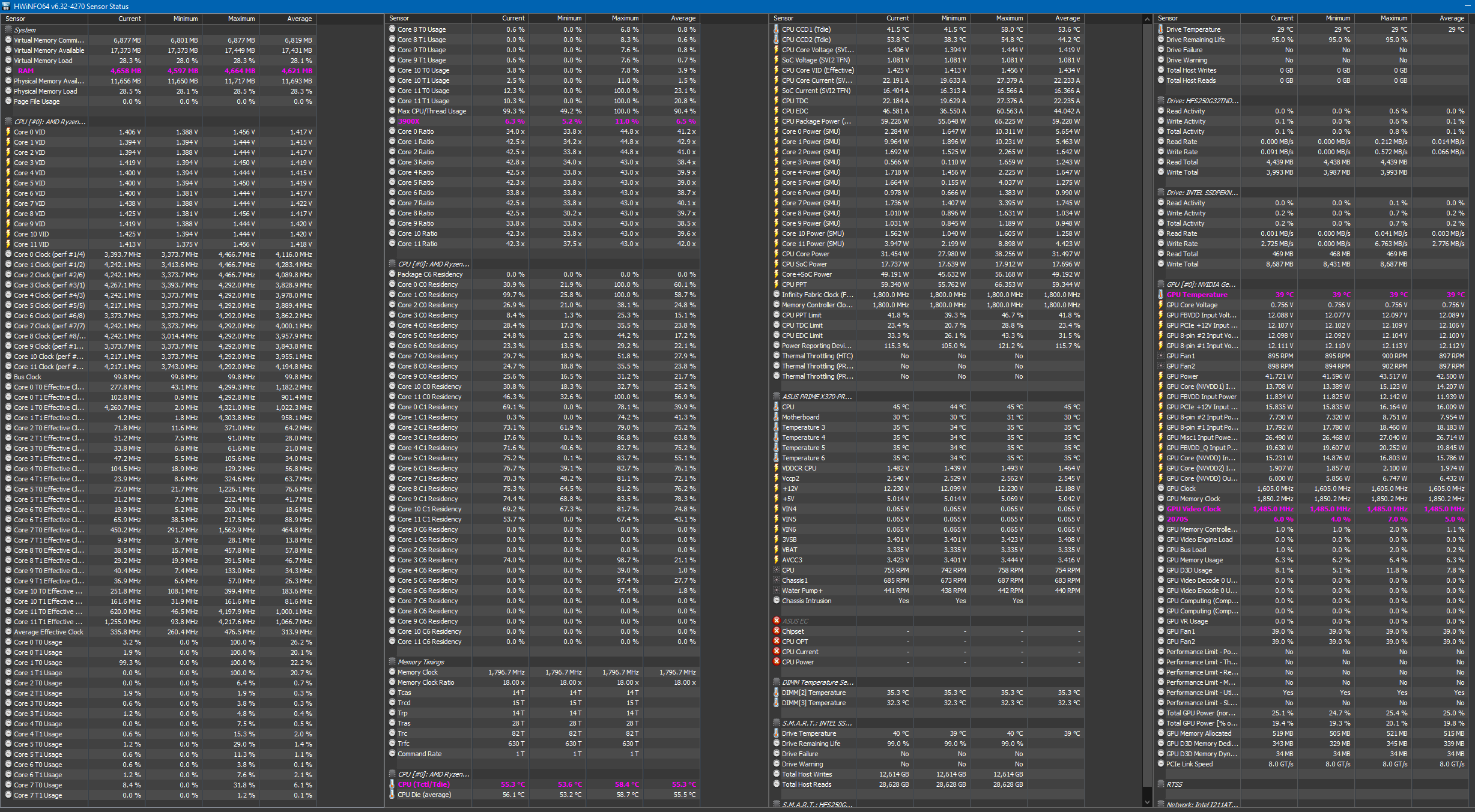

Mine idles around 36 to 38 in windows with spikes into the 50s in normal use. Gaming mid 50s with a 360m aio . Cb20 it hits 70 degrees just about.
Auto voltage it draws 142w performs worse and hits 80 degrees after sustained cinebench runs. I run 1.28175v fixed on my asrock taichi x470
