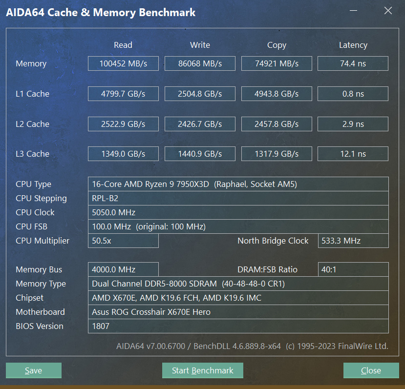

I'm impressed with x670e Hero BIOS updates. I picked up a GSKILL 8000Mhz kit as I found it on sale for a great price. It's listed on the QVL for the x670 hero (F5-8000J4048F24GX2-TZ5RK). It's not an EXPO kit, it only has Intel XMP profiles.
Updated BIOS to latest, installed RAM, set DOCP profile 1 (ASUS's terminology for loading Intel XMP on AMD) and booted quickly. Did a few tests, completely stable.
Quick AIDA64:
If I get time (doubt I will) I'll have a play to see if I can tighten timings up a bit.
