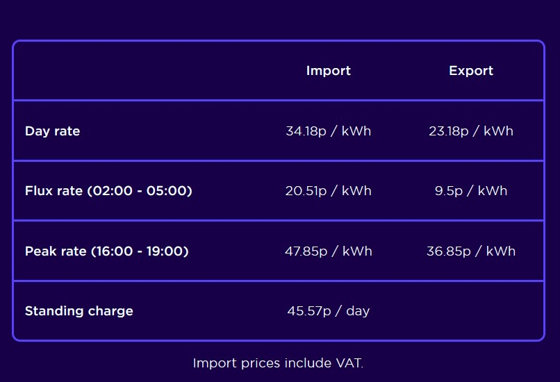

I have batteries but once they are full I export. By 9am I'm exporting. During the day I get 23p per kWh and between 4-7pm I get 37p.

You're information is out of date, enter Octopus Flux.
I charge my batteries between 2am and 5am every day regardless of the weather, this costs less than I can export at later in the day, once the batteries are full excess is exported, then come 4pm to 7pm I discharge the batteries to 45%.
Over the last 27 days my electric cost has been -£174 :D
