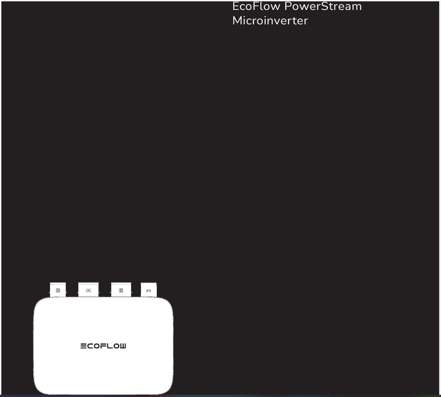

Discussed, but not actually explained - in fact the last time you "explained" it, @Bug One seemed to be left just as confused
Edit:
Manual is here: https://websiteoss.ecoflow.com/cms/...erter User Manual V1.1 (EN)_1686293304065.pdf
and seems to show it connected only via plug (the app shows options to prioritise either prioritizing power supply or power storage)
Edit:
Manual is here: https://websiteoss.ecoflow.com/cms/upload/2023/6/9/EcoFlow PowerStream Microinverter User Manual V1.1 (EN)_1686293304065.pdf
but i showed you a picture of the grey box on the wall....thats a micro inverter, so its doing the same thing as the inverter in your attic or the enphase micro inverters on panels. Its also a special charging socket and plug, that links to your fuse panel
i mean your current inverter is connected to the grid via an ac cable into your fuse panel. This is connecting the microinverter to a special ac plug and cable, via an ac socket to your fuse panel.
Whats the difference???

I can see a grey box on the wall - in fact have some more pictures of it
Where in their documentation is this mentioned, or are you just assuming? A special socket is not mentioned, nor any special connection to the fuse box, beyond that provided by a normal socket.

The cable goes direct from the AC OUTPUT in the above picture, into a standard wall socket? There is no special connection to my fuse box beyond the standard ring main back to the fuse box???

no assumptions being made...the documents call it a micro inverter....thats needed to turn the dc from the panels to ac for the battery and other ac outlets. Thats what inverters do.
The documents also ref smart plugs, they could be just standard smart plugs, but who knows, but they are ref: multiple times in the sections.
Even if it is connecting to standard ac socket in your wall....in a way thats the same as a solar inverter in the attic, but that would have its own fuse within your panel. if it is a plug and play option, then yes no special wiring is required. I would just question why it needs smart plugs and what smart plugs it requires
It's not just a micro inverter though. It's a small, but fully functional smart hybrid inverter. Connected to a standard, existing 3 pin socket.
Ahh - something I've just found. Systems under 800w are exempt from G98. That might be why they show 800w as the maximum you can set the output to in app.
