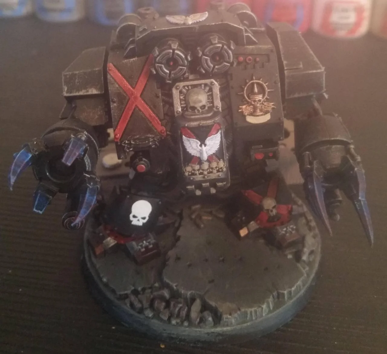

I was really happy with my dreadnought so far, probably best bit of painting I've done in many years. Then those lotr models pop up.. Makes me look like a child with a crayon lol!
