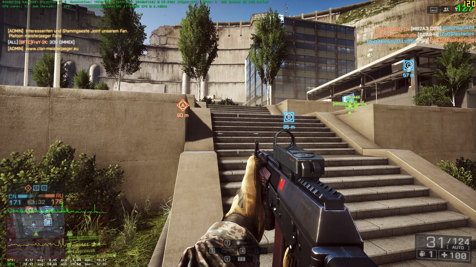

That lag stutter is similair to what i get with the big cpu spikes on performance overlay. Had to drop all settings to lowest to sort it. Not ideal on a card that should handle the game fine on max at my res.
I get a small lag spike every minute or so. Its playable but its far from ideal. I've not tried the game for a week or so but ill load it up now and snap a screenshot to show you what i mean.
I updated PB and it seems to be much better now, nowhere near as bad as it was when i last checked a week or two ago. Not sure if the PB update made the difference or if it was something else. The odd small lag spike was still present, but it was smaller than previously and occurred less often. Mrs is streaming tv shows on my internet as well so i guess its possible that could have something to do with it. Will check again later to confirm.
SPIKE
