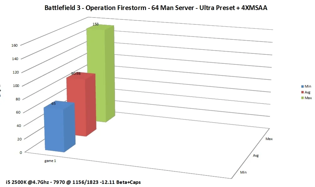

BF3
Test Scenario: 5 minute play through of the campaign level, Operation Swordbreaker. Fraps run begins the moment you leave the APC and ends after the large battle in the car park.
Ultra Settings - No MSAA
(Note - MSAA not used as it is completely unplayable on any of the cards. Technically the HD7970 manages 30fps average but it certainly didn't feel like 30fps when "playing".)
12.8 - 45.06 Avg / 28.00 Min
12.11 - 50.58 Avg / 32.00 Min
Improvement - 12.3%
Looking closer at the actual performance, it is clear that the 12.11 drivers are consistently faster than the 12.8 drivers in this test.
Custom Settings - "high"
12.8 - 59.00 Avg / 45.00 Min
12.11 - 67.74 Avg / 52.00 Min
Improvement - 14.8%
Again it is clear that the 12.11 drivers are offering a noticeable gain in performance. Note also the performance improvement over the HD6970, 90% average and 100% minimum!
This graph is comparing the HD7970 Ghz on the 12.11 drivers with a MSI GTX 670 PE OC card. This particular 670 benches very closely to a reference 680 (2FPS down on Average but identical minimums).
The HD7970 Ghz ends up 27.9% faster overall with minimums 33.3% higher.
Overall this is the most interesting BF3 result as it the first time I have seen the HD7970 to be noticeably faster than the 670 OC/680 in game. Even over clocked, albeit relatively mildly at 1200/6800, the 680 can't catch up managing 61.47 average and 45 minimum. I would imagine that ah highly clocked GTX680 should be able to catch the HD7970, but the HD7970 does appear to now have the legs a bit at this resolution.
