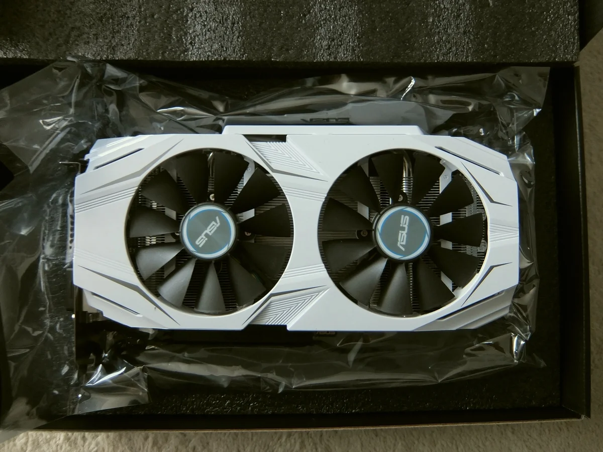

Can anyone with the Asus Dual OC tell me if they get anywhere near the 1.3 ghz core clock speed? Out of the box, in fire-strike for example (but also in games), i'm consistently getting less than 1.1 ghz.
I need to up the power target massively just to get the advertised core clock. Is this normal?
It's seems like the XFX GTR XXX (which i know is much more expensive) can peg a reliable 1266 mhz with no dips at stock.
Would be interested to know how other peoples cards behave at stock.
I have to actually underclock my Dual OC to 1205mhz and decrease temp rate to get it stable, otherwise it crashes a lot. Definitely just the card as an old R9 290 I have works just fine, as does a 4GB RX480.

yes you have to up the power target to get it to run at boost speeds.
I never got the Asus to a point I was happy with so now own a XFX GTR XXX instead. Consistently 1288 out of the box with stock settings and quiet, would recommend. :)
