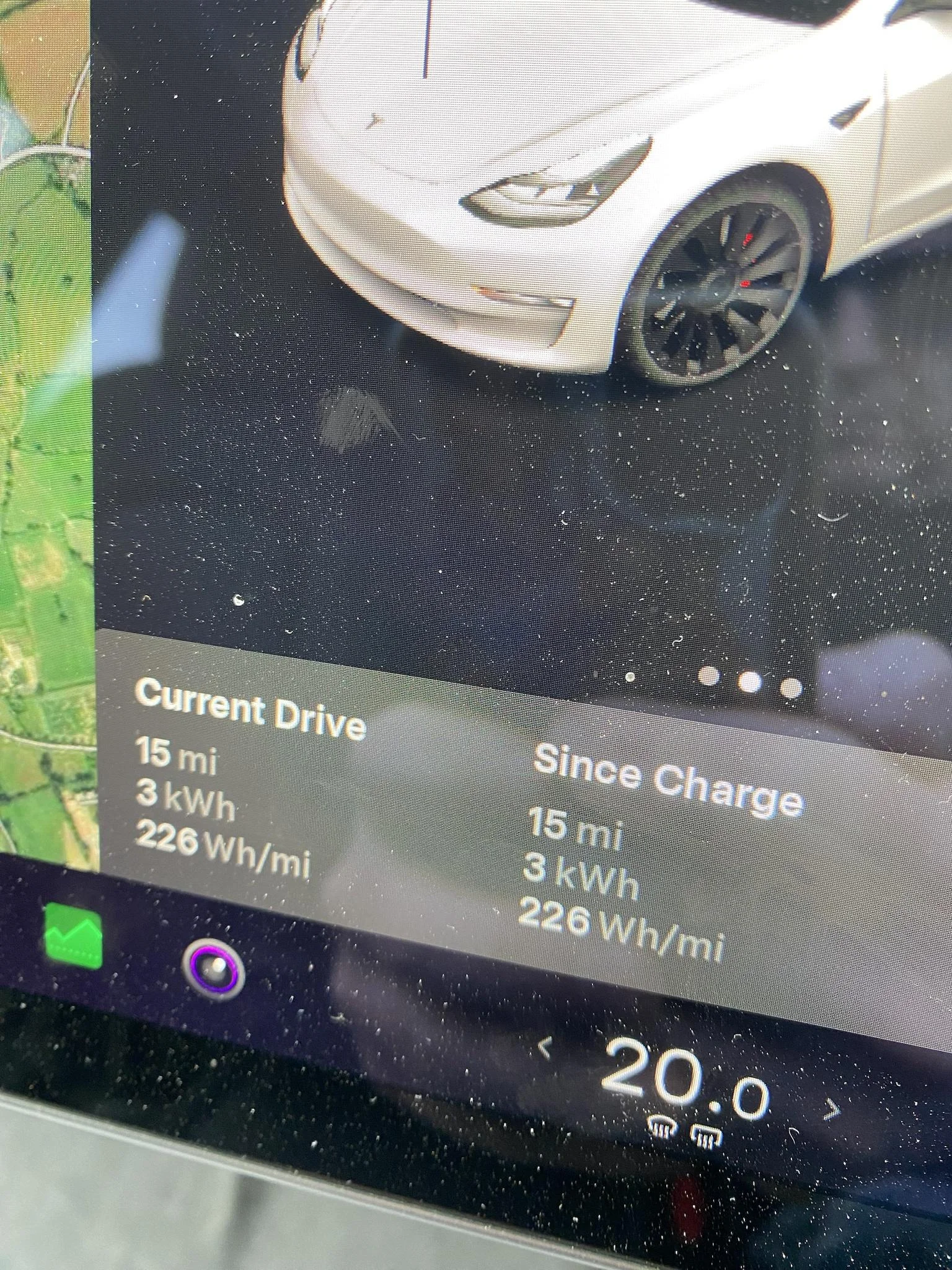

just done my usual commute. Battery was at 69% (my charge setpoint for daily use)
1mile B road, 4 mile A road, the rest Motorway @70 today to be sensible as its wet, heating at 20, I assume it preconditioned before I unplugged this morning and result....
It’s the missing 15kwh really. 307 is ok for 70-75 in the rain I thought. Way there was about 295 on dry roads and more use of the silent pedal
