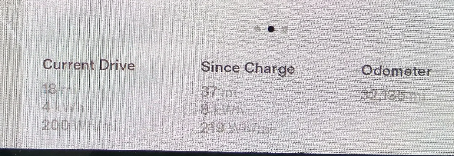

My average over a year is about 320W/mile with the 3 performance so about 3 miles per kwh. I use the acceleration and do a lot of shortish journeys in addition to my commute.It's not really that relevant how much it costs to charge from low % to 100%, you don't drive it down to empty and then charge it back up again like an ICE car. You'd just plug it in daily and replenish what you used while you sleep and you wake up with a full charge. The cost to run depends on how many miles you do and how hard you drive it.
You should be able to get roughly 4 miles per Kwh when driven inside legal limits in the real world. Ignore any range claims from any manufacturer, WLTP is not very real world. How much do you pay for your electricity? Divide that number by 4 and you have how much it costs to drive per mile.
