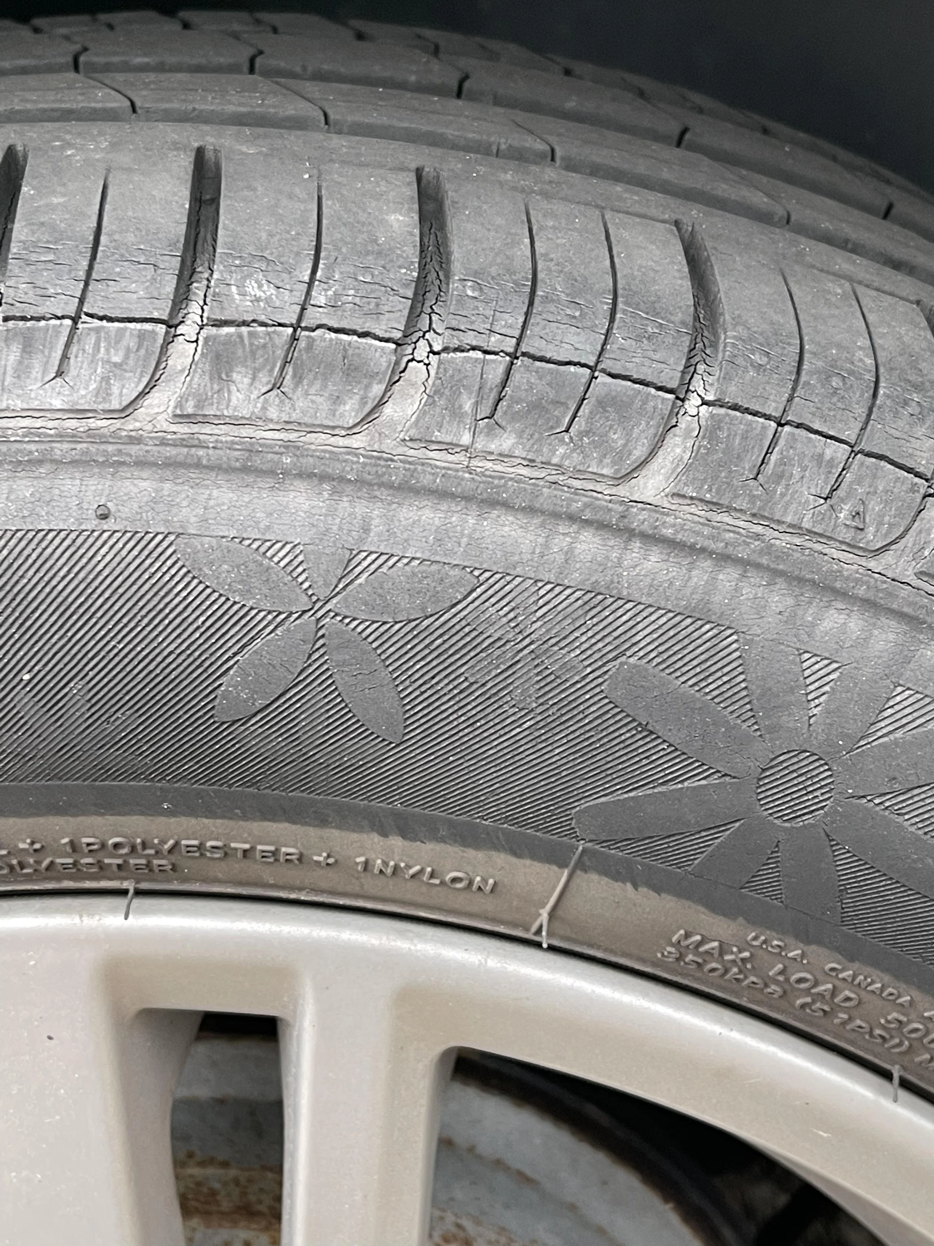

What could have caused this? both my daughters back tyres are like this, she hasn’t ever had them under inflated or ran them flat, it’s strange that both are like this
UV exposure and age!

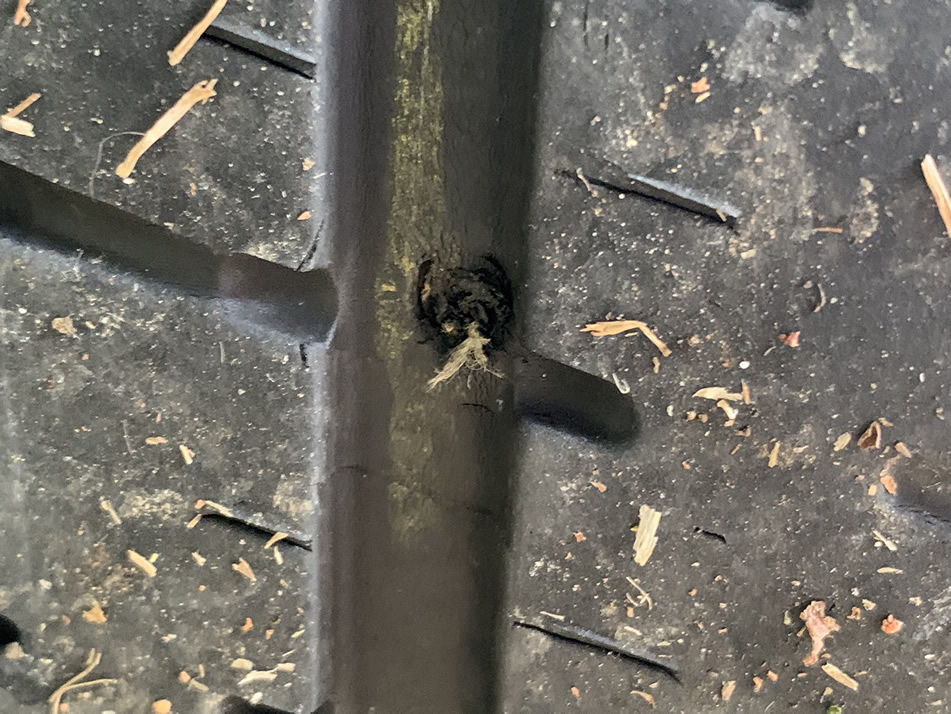

A recent BMW health check flagged up this on one of the rear tyres. Looks like something has gouged the tyre a bit... they said it would be an MOT failure, any thoughts?

Have you had the tyre since new? possibly a previous repair which is now degrading? though with the marks around it probably all from going over the same object.

Strange one, it even possibly looks like a previous tyre repair, unless you've had the tyres from new? If so, it would likely be an MOT failure for "ply or cords exposed". Even though you can't see the cords as it stands right now, they are allowed to use a blunt tool to pry into the hole to see if it goes down the cords or not. With that being in the trough of the tyre grooves, it likely down go down to the cords. As mentioned, the easiest thing to do is pay a tyre company to do a puncture repair on it for £20.

I'm going to stop by my local tyre place and ask their view on it. The tyres were on the car when I bought it so no idea if it's been repaired before.

Yeah I'd agree. I noticed something similar on my Dad's SUV which has a wide gap between arch and tyre. When in the sun, the wheel arch puts the top of the tyre into the shadow of the arch, and the tyre wall is in the sun. The cracking (albeit slight on my Dad's motor) is on that line between the shade and full sun and obviously you can't put tyre dressing that high up onto the start of the tread block.
