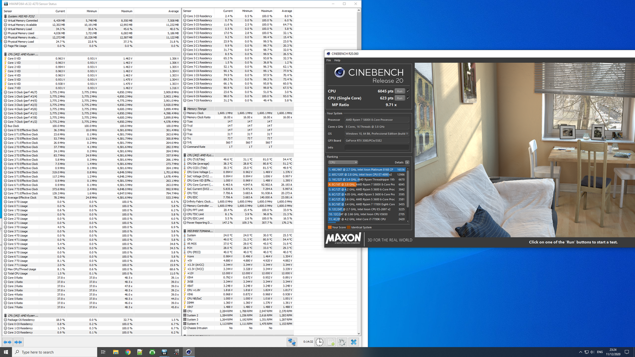

I am having the same problem at the moment. Until recently CO massively effected boost clock. Now no matter what PBO setting or CO setting I use, my single core boost is not going any higher than stock. I can set PBO + 200 CO -10 on all cores and the single threads aren't pushing past 5000. Previously they would shoot up to 5200+ on some cores. I have done a BIOS reset which did nothing and currently putting on a fresh install of Windows to see if it was Ryzen Master screwing with it. Failing that, I will try lower Ram speed with lower VSOC voltages. I think it could just be buggy with the current BIOS at the moment.
You can see this image of my heavily under optimised CO when I had no idea what I was doing I got this result. I think PBO was +100 and I set the 2 fastest cores to -10 and the rest to -5. I managed to get all cores going over 5000 on a better optimised CO, but didn't take a pic of that.
Now this is with PBO + 200 and CO -10 on weaker cores CCD 0 and -5 on best and -15 on CCD 1
It is lower than my stock scores. Either my software is reporting incorrect info, or something is screwing with the boost.

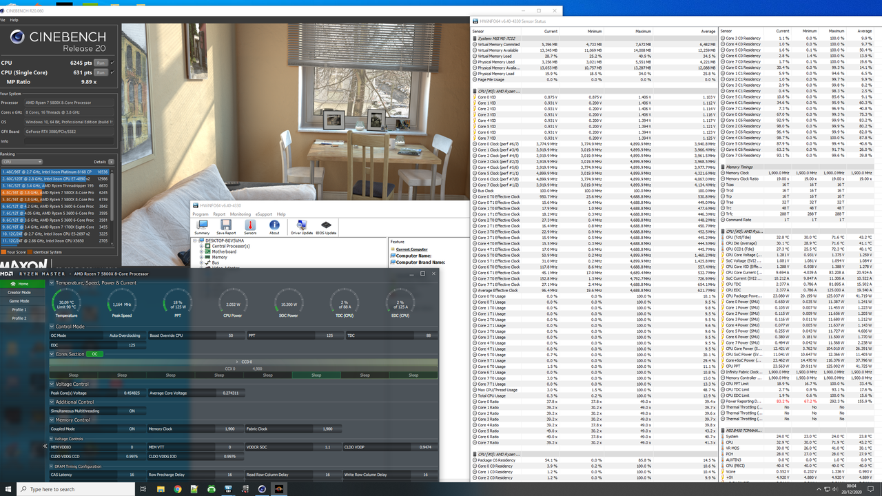

Sorted the PBO problem out with a fresh install. But you can see HWInfo recording the wrong speeds. Ryzen Master shows every core reaching over 5ghz using Boost tester with an optimised curve, however HWInfo shows a huge discrepancy. You can see Core 6 reaching 5135 in Ryzen Master, but only 4950 on HWInfo. Reducing the polling in HWInfo makes no difference either.
