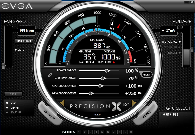

I have the samsung memory, here are the settings that I have applied at the moment.
do they look ok or shall i go higher on the memory? i have the kfa2 soc 980
