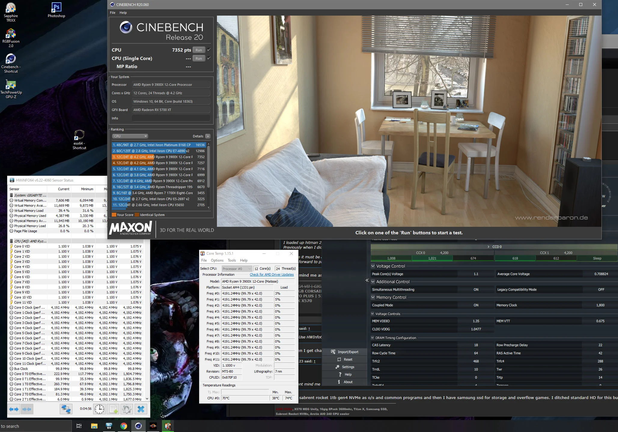

I tried a per ccx overclock in the bios.
Just upped ccx0 to x39. Instant BSOD when I out a load on.
Odd as with auto everything I get 73xx and 52x scores in CB20.
I see 4.6 on a few cores and 4.350 the lowest on the other chiplet when running a single thread test. So figure I've got an average chip.
On review, this seems unbelievable. Far too good.
Agreed.

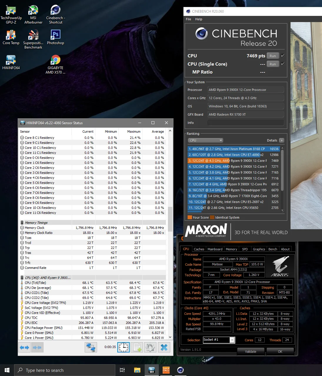

Did some further tinkering. When you change the default multi to anything but stock 38 and alter voltages in BIOS, it shows 1.1v in most places, which cannot be correct.
The only 'true' voltage i now look at is CPU-Z and in HWInfo 'CPU Core Voltage ( SVI2 TFN )'
4.3 all-core @ 1.28v ( in BIOS )

You may of passed Cinebench 20 but I can tell you right now, your chip isnt stable, I can tell straight away by that score, its too low for 4.3ghz, mine at 4.3ghz with the same ram timings as you scores 7768 and needs 1.33v to do that, 100% stable, after running that for a week or 2 though I soon figured out that there really is no point overclocking these, and just leave it at stock, tweak your ram and let PBO do its thing.
Yep he’s right, ju let it run stock, tune memory and tweak PBO to squeeze what you can out of it. Lastly, use the 1usmus power profile for another clock boost.
Yea I just enabled PBO and get a score of 7250 on average, pretty happy with that and not bothered about trying to push it for a few more points. Chip only hits 67c during the run as well.
