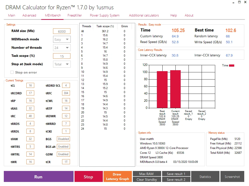

What is your ram timings rated for at 4000mhz ? remeber if you are shaving 400mhz off the speed and setting it to run at 3600mhz, you can tighten up the timings to make up for the loss of mhz, so 4000mhz CL18 should easily do 3600mhz CL16, use RyZen DRAM calculator to get a better picture of what you can try and aim for: https://www.techpowerup.com/download/ryzen-dram-calculator/
As for FCLK, just set to half of your RAM speed, so 3600/2=1800, not a lot of CPU's will do much better than 1800 easily without loads of tweaking, to see what that is currently running at, open CPU-z select the memory tab, at the top it says NB Freq, thats your FCLK speed.
