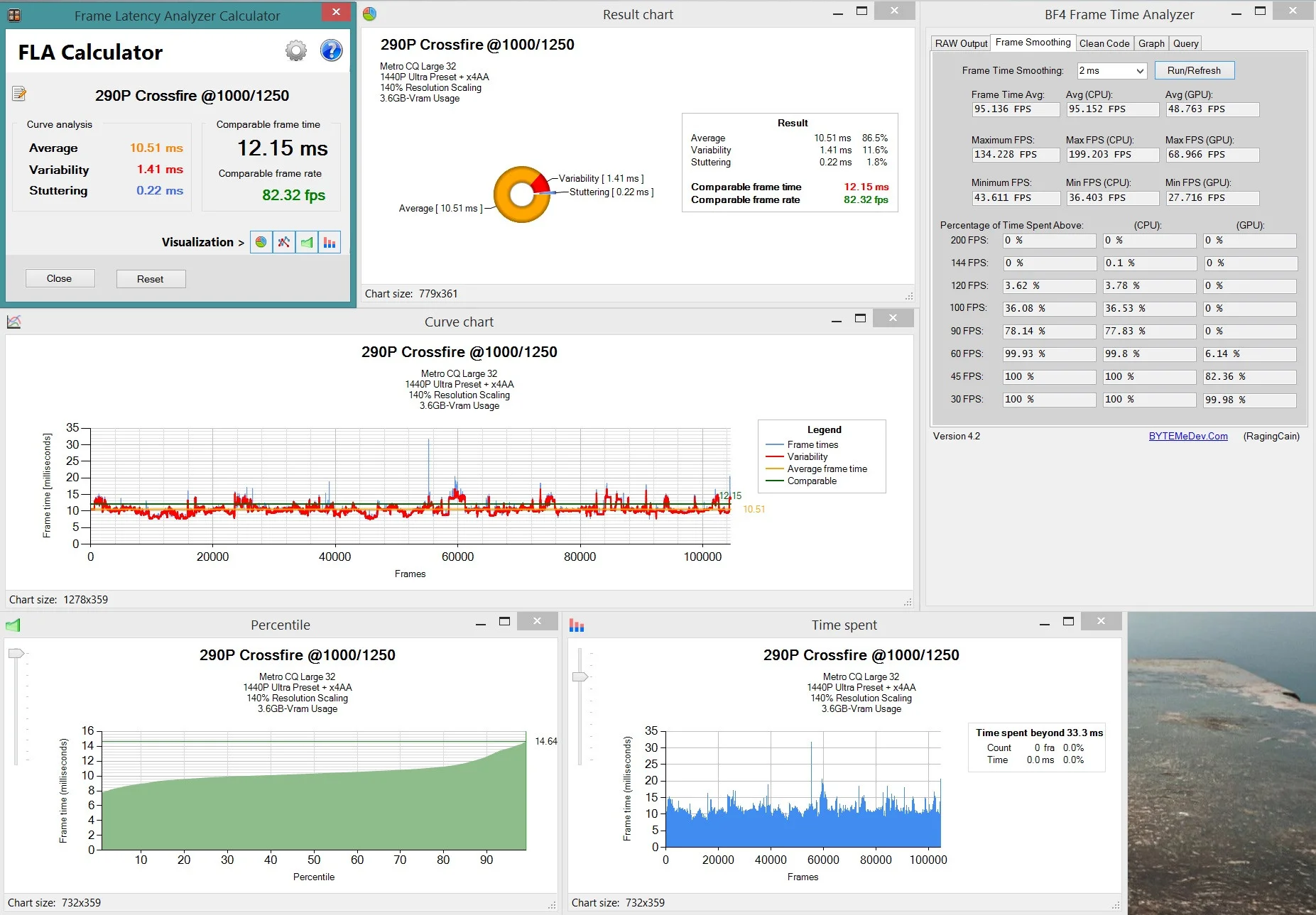

I tested it over the course of a long round when i did my benchmarks here. Usage starts off low but creeps up the longer you play. I'm also playing on Metro which is not one of the worst maps for vram usage either. Look at the screenshots.
1440P Ultra Preset +x4 MSAA - Mantle API
140% Resolution Scaling = 3584x2016
1440P Ultra Preset +x2 MSAA - Mantle API
150% Resolution Scaling = 3840x2160
Sorry for the rather lacklustre screenshot. Was pinned in base after i finished benching and this was the best i could get whilst under fire.

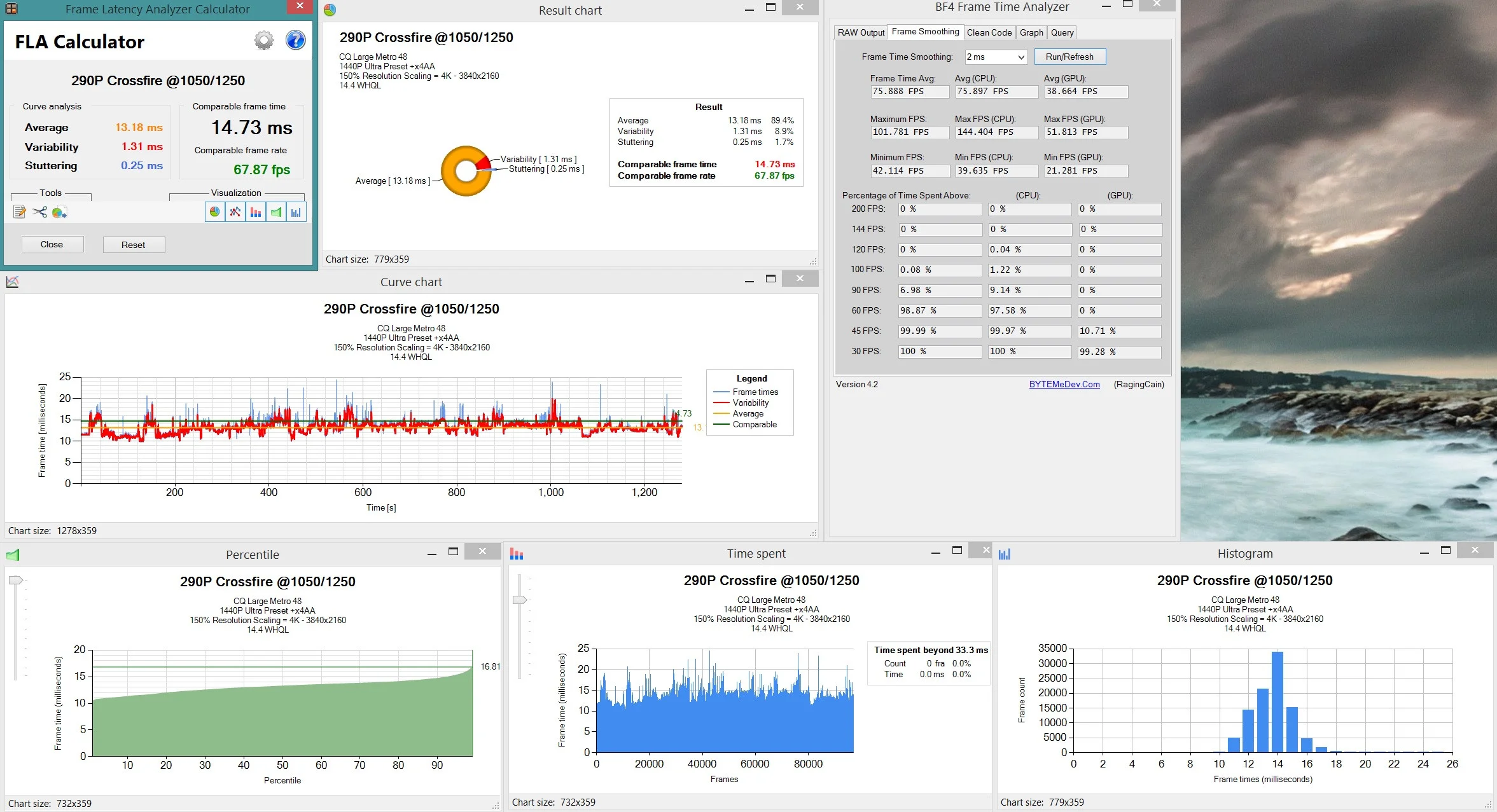

Next up, x4MSAA @4K.

Just had a go with Mantle and DX11 on the 290s @4K settings
Mantle used 4.4gb of VRAM per card.:eek:
DX11 used 3.2gb of VRAM per card.
DX11 was very smooth and playable with good minimums and and very high average.
Mantle was all over the place with fps huge spikes on the CPU and the average or minimum fps was no where near as good as DX11.
I don't think multi GPU setups, 4K and Mantle are a good option as it uses way too much VRAM and that is what is causing the spikes on the CPU. At the moment DX11 seems to be the best option for extreme resolutions.

I have just enough vram at 1440P Ultra preset with 150% resolution scaling (4K). Its a smooth and playable experience. However its right on the limit so its possible after a map or two it would exceed that limit and begin to stutter. Possibly on a bigger map, like Caspian it would not be enough and would stutter from the outset. As you're at 1600P, your usage will be even higher. Its how i knew straight away when you said '3.2GB usage and stays there' that was not correct regarding Mantle.
I expect resolution scaling uses more vram than running 'proper' 4k as well, as it has to store the image whilst it downsamples it to the resolution of your monitor.
